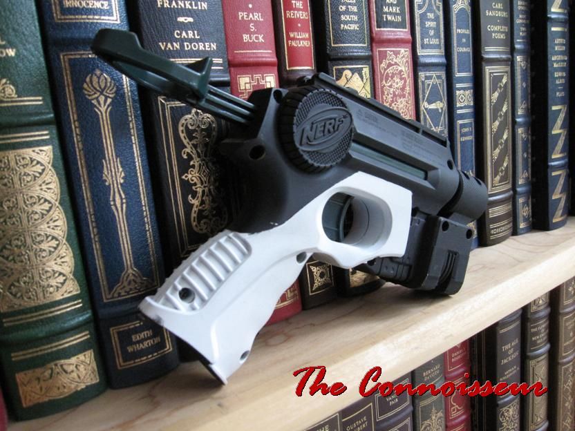

Introduction: Nerf Mods: a Beginner's Guide
About: I'm Alec. I like to post Instructables whenever I get to work on my own projects. But, that isn't exactly all the time. I usually find myself pretty busy with school, so it's not often that I actually have …
Beginners can be easily repelled from the world of Nerf gun modding by seeing a modification "write-up" that seems complicated. Many modification write-ups do seem confusing at first. However, modding a Nerf gun isn't very hard--It simply takes knowledge of how a Nerf gun works and how a mod should be executed. With this knowledge, modifying Nerf guns is quite simple.
This Instructable will introduce you to the vast world of Nerf gun modifications. It covers basic concepts of Nerf gun modifications written for complete beginners--those who are interested in Nerf guns but unsure of how or where to start.
