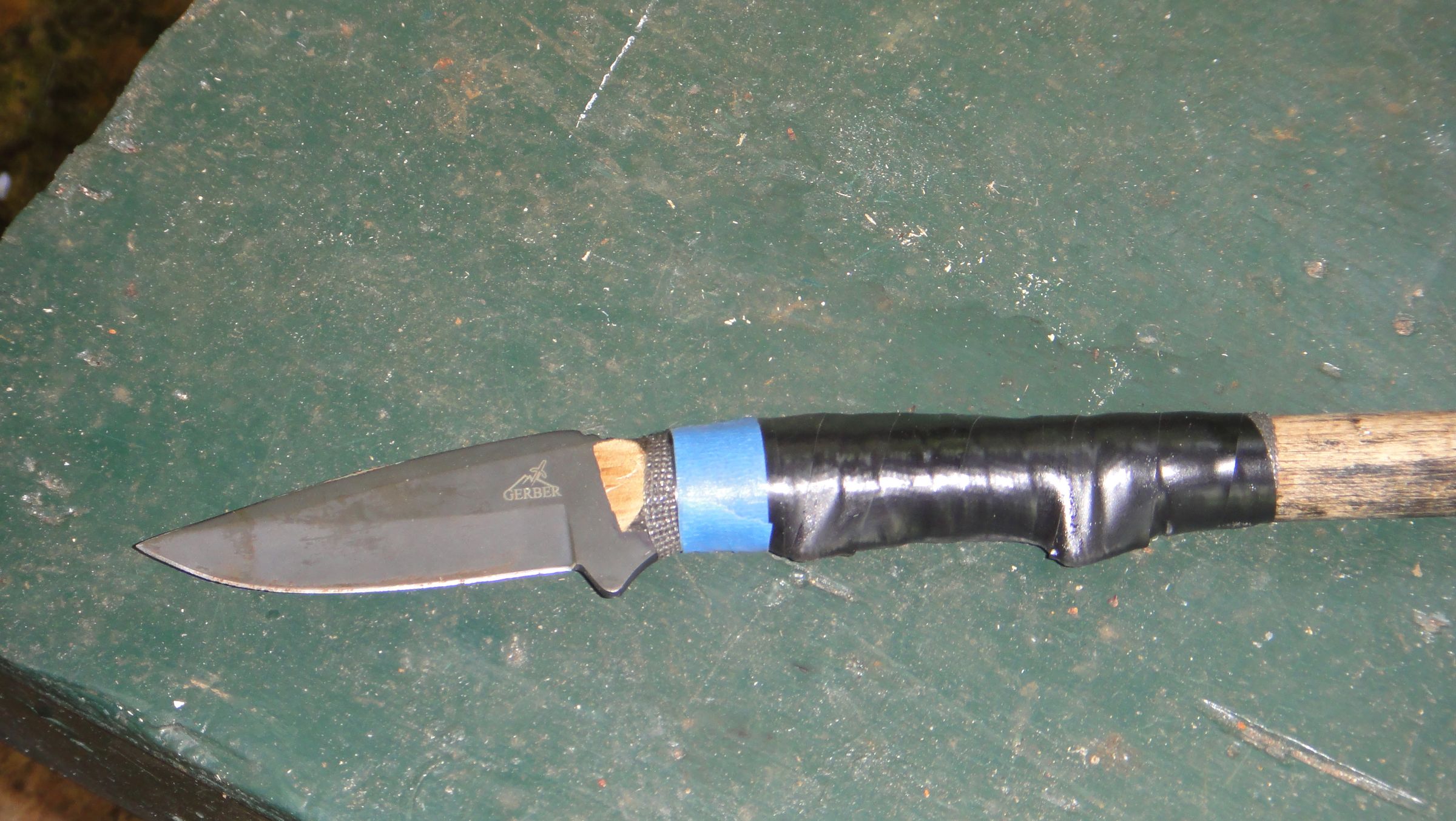

Back to work tomorrow! The other image is one for a sickle I broke a wile back. I turned it into a harvester. Not sure if it would work good or if it was safe so no 'ible for that one, but I think you can figure it out now.
