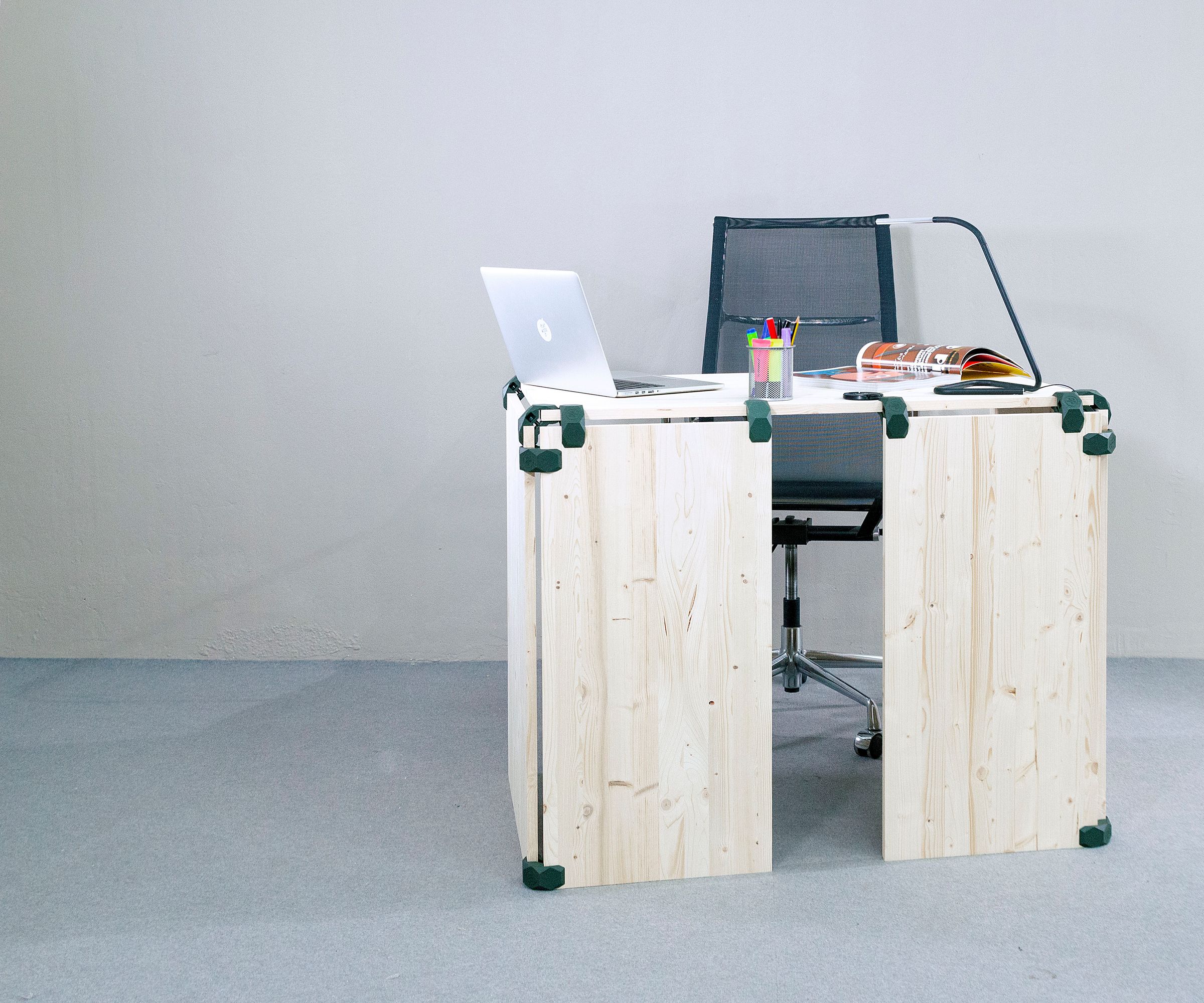

The assembly is quite easy: Firstly you have to build the rack.
You should take your fir layers boards and connect them one another through a junction system, in my case I used PlayWood Connectors 90°. After that you should nail the two sides, in order to stick the wooden bar in the rack and create a clothes stander.
Step 4: What Are You Waiting For?
Easy, peasy shelfy squeezy: In a couple of steps and less than 10 minutes of work you create a kid’s wardrobe.
It’s brilliant that you can dismantle the project in a couple of minutes by using only an Allen Key!
