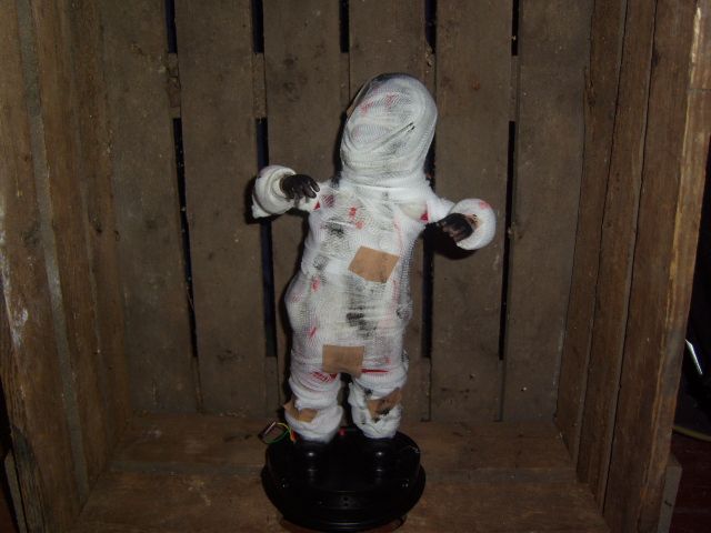

What happened? Many years ago Santa Claus died in an accident. His little helpers wanted to conserve him and mummified his body before they buried him. All children of the world were sad, because Santa was dead, so a good willing daddy tried some mystic magic to get him back to life... It worked, well, not really, Santa waked up on halloween to terrify the world....
Last year I wanted to join the Santa Pede Challenge from Hackaday, but I never had the time to modify a dancing and singing santa to something walking. So I had this "Dancing Santa" still lying around. Today I came up with the idea to modify it to a scaring halloween mummy. I did some simple circuit bending mods and moved the LEDs from down to the top, covered the whole Santa with gauze bandage and thats it! Follow the instructable to make your own!
This is how it looks in the dark (see the flashing eyes and heard):

Put the LEDs into the head and stick it to the body. Close the case. Now Santas guts are modified and Santa is ready to get dressed like a mummy!
Step 6:
First, bend the ams in mummy style. Cover the head with electrical tape, leave only the eyes free. This makes the eyes flash! Cover the whole body with gauze bandage. Use some water color to make it look a little more dirty. Turn it on to test if its still moving. If not, the bandage is too tight.
