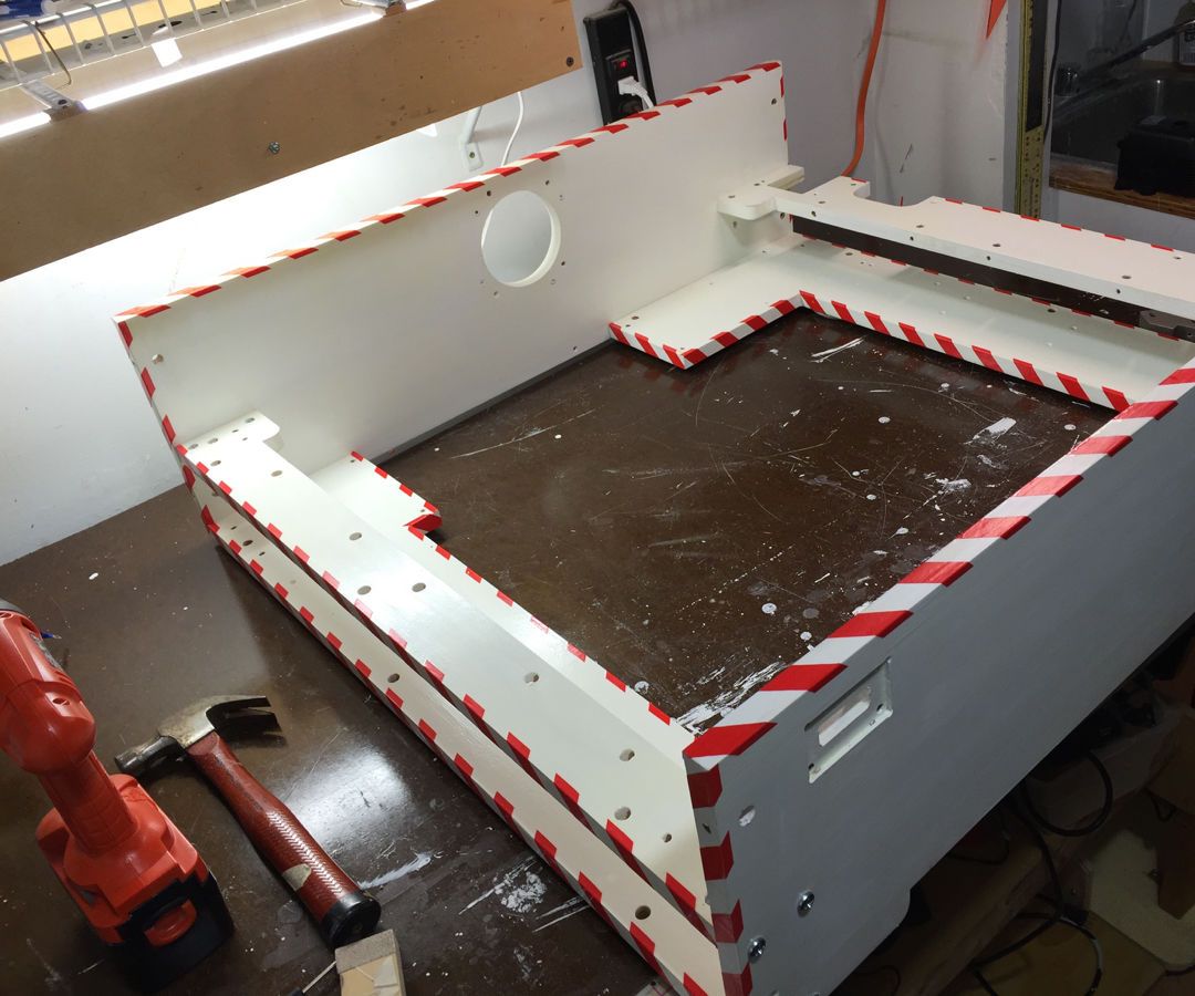

The box was designed to hold the switches and the gauge. The depth of the box was actually determined by the large gauge.
My first attempt at making an enclosure was rather pathetic; I cut the wood by hand using basic shop tools and glued it together. It worked, but it just wasn't good enough for me. The first version had the wiring routed through the copper pipe coming out the side. The second version had the wiring routed out of sight through the wall.
The project stayed in that half-finished state until I purchased and assembled a BlackTooth laser cutter. Now, instead of trying to cut the wood pieces by hand, I let the computer cut it for me. The panels of the second box were designed in Google Sketchup. Sketchup is great for 3D object design, but 2D images can be created in it too. All the pieces were cut in 15 minutes with the laser cutter from a single piece of 1/8" Baltic Birch plywood. The interlocking edges made glueing the pieces together a piece of cake.
