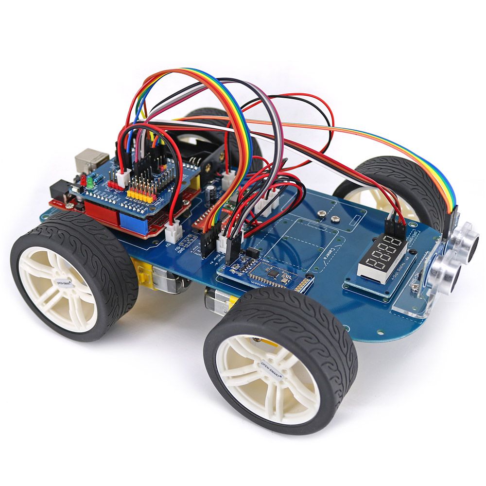

The kit is bluetooth remote control smart car kit that is designed for Arduino development. Every step has a clear graphic explanation, so the installation is very simple.
It contains an Arduino compatible PCB chassis that can be easily installed with Arduino UNO R3 / OPEN-SMART UNO R3 or other compatible motherboards.
You can follow the installation tutorial and
video to assemble the car, and each step has a clear graphic explanation, the installation is very simple.
Gear motors and battery holder are all
XH-2.54 connectors, so you can plug them directly onto the corresponding white socket on the chassis.
After installation, please follow the
operations in the tutorial video, so you can directly use the android phone to control the car.
In addition to use the touch buttons on the
APP page, you can also use the gyroscope control built in the phone.
The kit can help you learn Arduino programming and learn how to make interesting projects, such as ultrasonic distance measurement and display, ultrasonic obstacle avoidance, bluetooth remote control smart car.

Step 1: Install the Hardware for the Smart Car
Follow the 4WD Car 02 Hardware Installation Tutorial.pdf to install all the parts of the car.
Step 2: Install Libraries
Download 4WD Smart Car 02 Lib.rar and uzip it.
Then put the 5 file folders into the libraries directory of your Arduino IDE. Mine is D:\arduino-1.6.5-r2\libraries And then restart the IDE, such as close all the IDE windows and then click arduino.exe again.
Step 3: Upload Sketch Code
Plug the USB cable to your PC and the board.
Open the demo code \arduino-1.6.5-r2\libraries\CarBluetooth\examples\NewBluetoothCarControl
Then select board type: Arduino/Genuino Uno
And then select the write COM number for the board.
Then click upload button to upload the code to the board.
