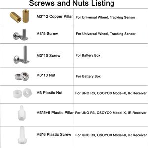

1x Screw Package

Step 4: Install Wheels
Accessories:
  • M3*10 Double Pass Copper Pillar x 4
  • M3*5 Hex Screw x 8
  • Screws for wheels x 2
Install the wheel on the chassis with M3*10 Double Pass Copper Pillars and M3*5 Hex Screws, then install the two wheels onto the motors.
Step 5: Install OSOYOO UNO Board
Accessories:
  • M3*6 Plastic Screw x 3
  • M3 Plastic Nut x 4
  • M3*5+6 Plastic Pillar x 4
Fixed the OSOYOO UNO board on the surface of the chassis with the M3 screws and nuts
Step 6: Install OSOYOO Model-X Motor Driver Module
Accessories:
  • M3*6 Plastic Screw x 4
Fixed the OSOYOO Model-X motor driver module on the surface of the chassis with the M3 screws and nuts
Step 7: Install Battery Box
Accessories:
  • M3*10 Screw x 4
  • M3 Nut x 4
Fixed the battery box on the surface of the chassis with the M3 screws and nuts.
Step 8: Insert Wi-Fi Shield Into UNO Board
Insert Wi-Fi Shield into UNO Board
Step 9: IR Receiver
Accessories:
  • M3*6 Plastic Screw x 2
  • M3 Plastic Nut x 2
  • M3*5+6 Plastic Pillar x 2
Step 10: Tracking Sensor Module
Accessories:
  • M3*12 Plastic Pillar x 2
