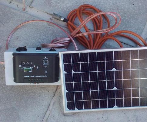

will doubtless read this and think “duh… bit obvious”, but the idea for this came from a conversation about whether it was possible to power a slow cooker from an off grid 12V setup (the answer to that being “yes, but it needs a lot of batteries”). Which got me thinking of alternative off-grid ways of slow cooking, which in turn led me to the question “what would provide a low level of heat over a 6-8 hour period?”.

To ensure good ventilation I pulled out the drill and put a series of 2cm holes in the underside of the box along 2 sides of the box, because the box would be off the ground due to the rubber feet I’d fitted, this meant air could be pulled into the box from the underside. I also got the holesaw out and put a 38mm hole in the side of the box, in the corner “opposite” the centre of the right angle of holes on the underside. Inside that hole I fitted a 40mm 12v pc ventilation fan, the logic being that once running that fan will draw old stale air out of the box and allow fresh air to be drawn in via the holes on the underside. The fan was then connected to a 12v power source and was good to go (and before anyone asks, I went for 12V as it would be easier to get off grid, also it would be a slow draw of air and less like to cause the candles to go out).
In fact on my first test cooking I had 6 tealights running and there was no need to run the fan, but possibly if you run a lot of candles it may become necessary
