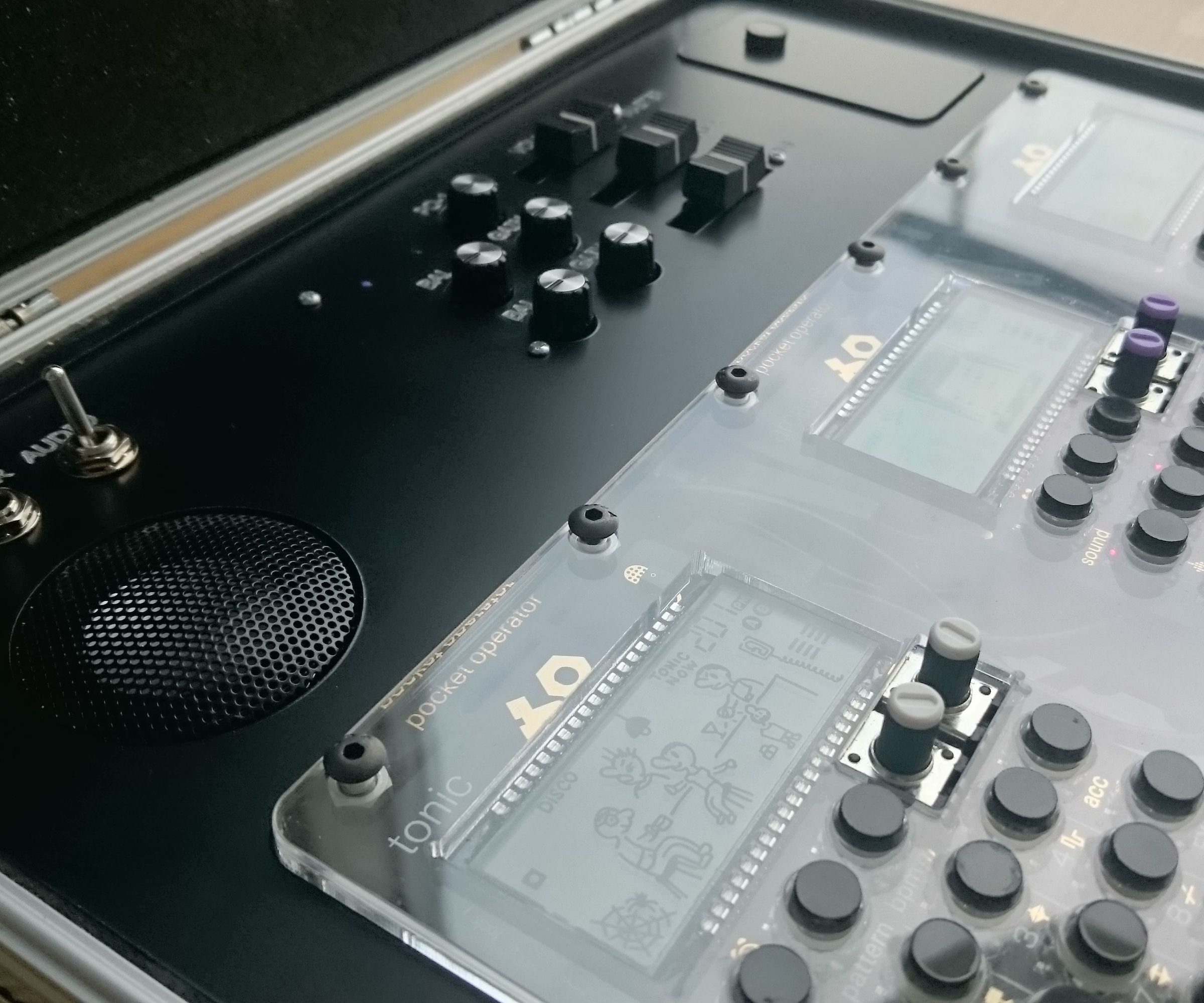

For those of you who expected this to be yet another handmade synthesizer case it might be a little disappointing, but today I'd like to share our experience building a full size arcade machine for our office.
