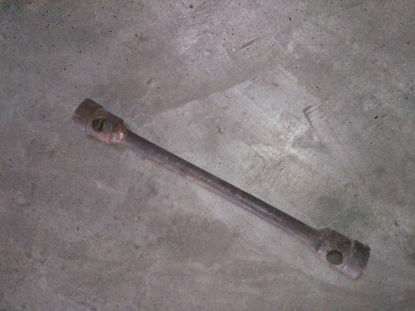

If you find it is hard to make a hole on iron pipe, then consider using a truck wheel wrench which already has holes on it, but you need to cut it into half or one third in length, otherwise it will be too long for working in narrow space.

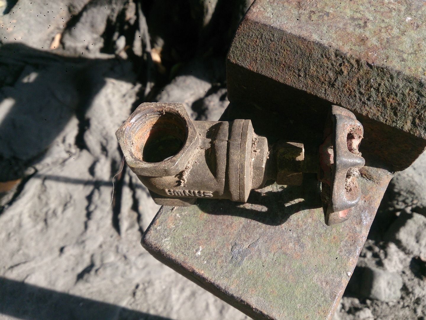

I have this old water valve that already has holes wide enough for the chain to go through. A lot of things can be used, as long as you have a good grip on it.

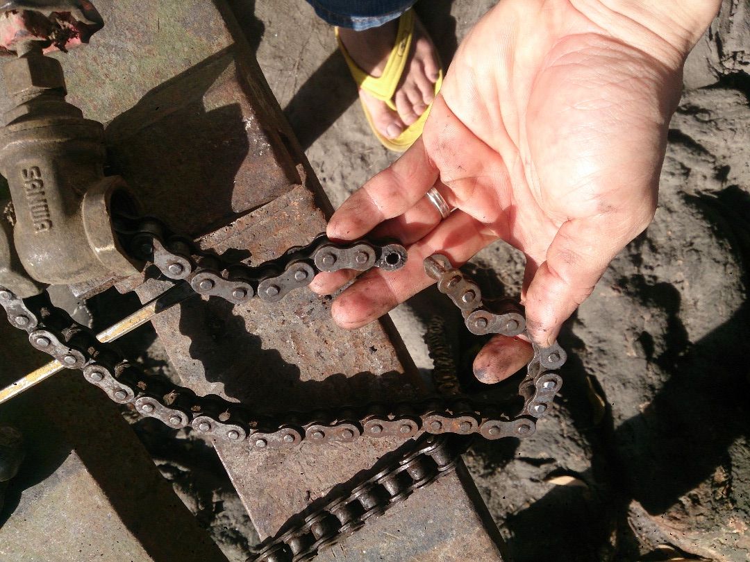

We need only about 30 to 40 centimeters of the chain, so we need to unchain it. It is okay if you bend it in the unchain process. They are made of hard steel but bendable. You can measure it directly with the largest oil filter can that your vehicle uses, remember to leave it a little bit longer so that you get better grip between the chain itself.

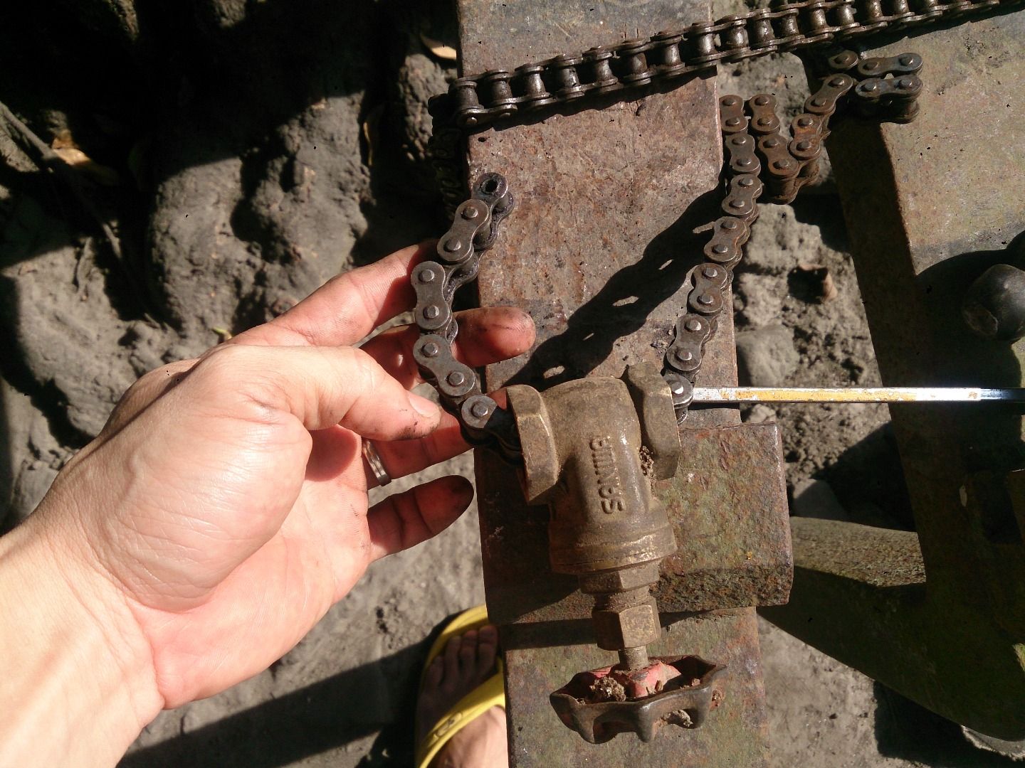

Let the chain goes through the valve/pipe that we are going to use as handle.
Now re-chain it to make a closed path.

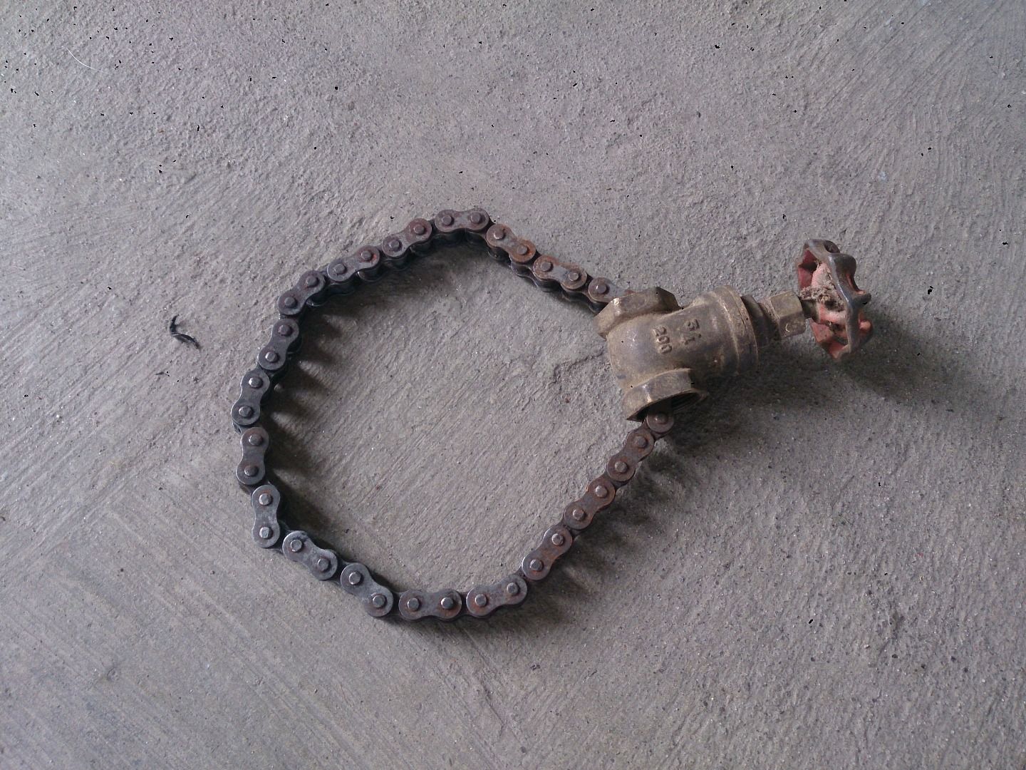

Step 3: Give It a Try
I think using this old valve is also good for narrow working space. It is not too big, yet gives us several hand grip positions to pull or push (loosen or fasten the filter can). Filter can has a polygonal side where there are many vertices (plural of vertex - the outer point of a polygon) that make grips to the chain. You need to use the other hand to align the chain to the can's polygon neatly so that they bite. Sometimes you need several tries to get a firm grip.
