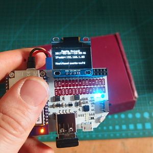

I have an Omega Onion2. I use also the Power Dock. With Power Dock, you can use Onion Omega2 with USB cable or little LiPo Battery. I saw OLED display, but I want I use a normal i2c OLED screen to show the ip and the name of my omega Onion2. The Omega Onion2 have a little screen module. I use this simple i2c OLED screen available on Amazon. The screen is completely supported by the Omega Onion2. I can use it also with the integrated Omega Onion2 console.
The screen can show text or graphic. You can use the Onion Omega2 console to use this with the integrated module. Type the text or put the image on the screen and see appear it on it after a second.
If you want you can install the OLED widget and play with the screen!

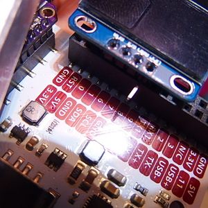

Step 2: Connect the Screen to the Onion Omega2
I use this little OLED screen available on Amazon. The screen has an i2c connection and a backlight led. You can use this also like a graphic screen.
You can connect the screen to the SDA and SCL Onion's pins. You must connect also the GND pin.

Step 5: Type the Stock Command
To run the project you must type .\stock.sh in the shell
.\stock.sh
You can see the
Omega Onion2
Date - Time
Ip Address
Host Name
Now after the start Omega Onion giving you the own ip address and the own hostname.
