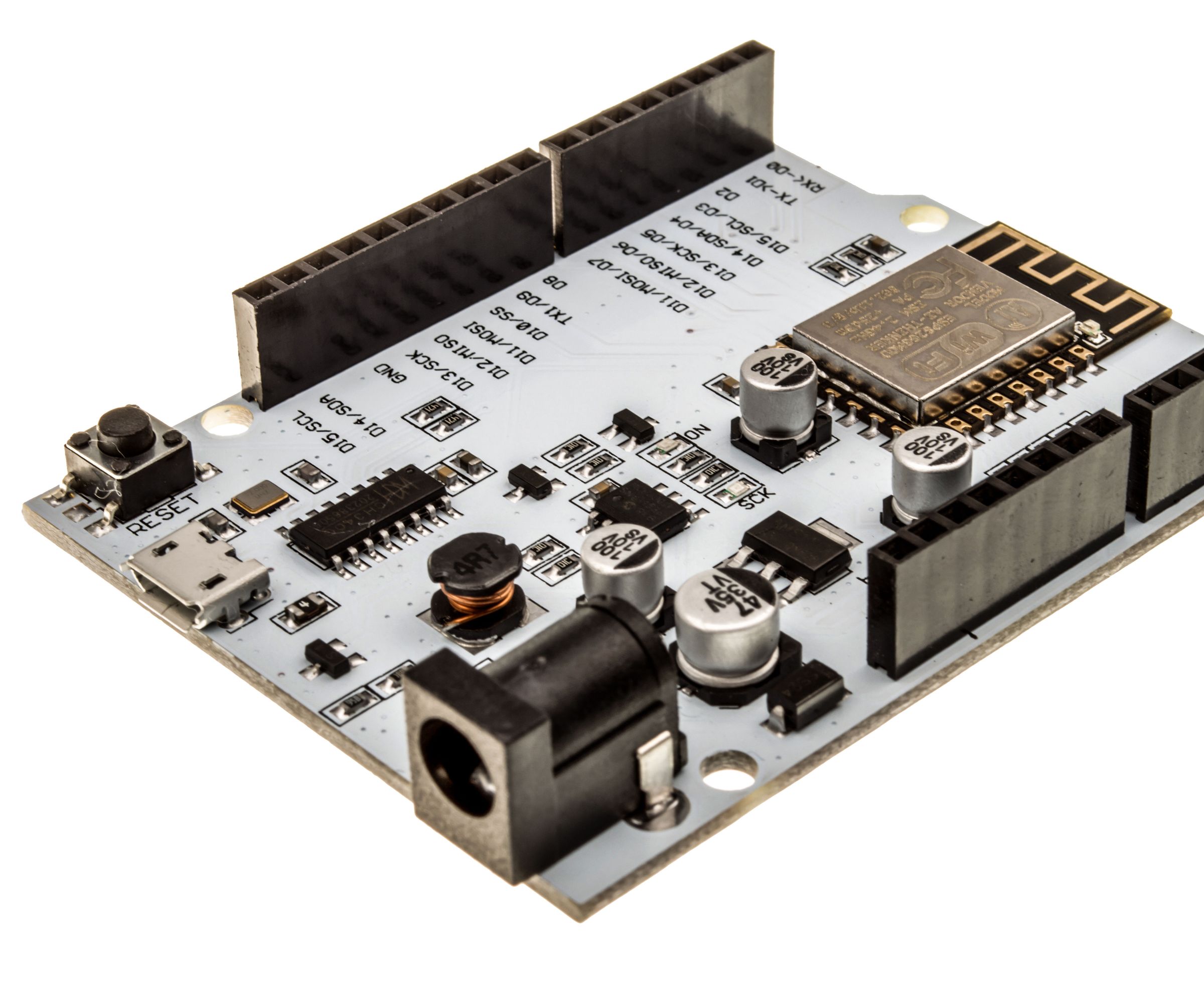

We has developed an open source home automation system which is based on a very cheap $10 WiFi development board LinkNode D1. It is Arduino-compatible WiFi board and is very easy to program.

LinkNode D1
Linker Base for D1

Peripheral Module LinkNode D1 Pins
T&H sensor GPIO0
Linker LED GPIO5
1602 LCD txPin GPIO14
Servo GPIO15
Relay GPIO16
O2 sensor A0

We use Arduino IDE to program the LinkNode D1 but the offical Arduino IDE doesn't support LinkNode D1 board, and we have to install the ESP8266 Arduino code pacakge, details please check the wiki page of LinkNode D1.
LinkNode D1 Arduino code
This code block connects the LinkNode D1 to the WiFi network using WiFi manager library which can make configure AP's SSID and password via web page.
#include
#include #include #include #includevoid linksprite_io_init() { WiFiManager wifiManager; wifiManager.setAPStaticIPConfig(IPAddress(10,0,1,1), IPAddress(10,0,1,1), IPAddress(255,255,255,0)); wifiManager.autoConnect("LinkNodeAP"); Serial.print("WiFi Connected ...\n"); Serial.println("WiFi connected"); }
