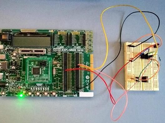

This project is going to explain the Interrupt On Change (IOC) feature on the PIC24 Microcontroller. An IO pin from the PIC24 is connected to SW4 on the Explorer 16/32 Development Kit, and it will write how many times the switch was pressed on the LCD. I will walk you through the steps used to create this project.

  • Hook up the USB cord to J18 on the Explorer 16/32 Development Kit board.
  • Click the green down arrow that points to the chip to "Make and Program" the PIC24.
  • Check Jumper J19 on the Development board and make sure that it is closed, so that the LCD will work.
Step 17: Test the Program
  • When you first load the program, the LCD will be blank until you push S4 for the first time.
  • Push S4, then you should see "SW Pressed 0" on the LCD.
  • Each time you push S4, the counter will increment and will update on the LCD.
