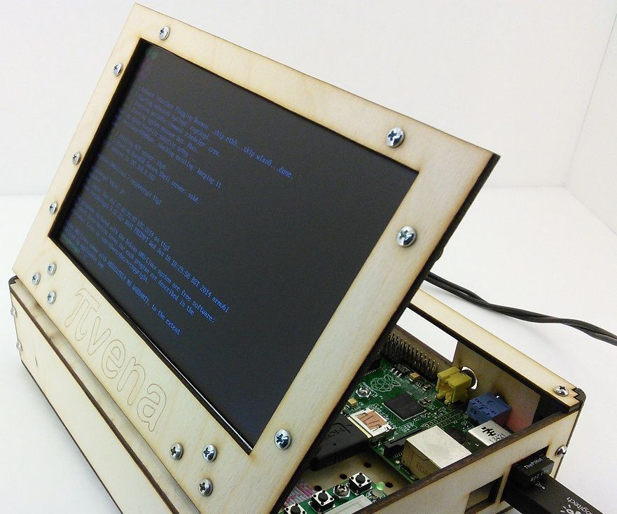

This instructable is going to show you how to assembling the PIvena Raspberry Pi Case! Head over to my website WildCircuits.com to read more about the PIvena or to thingiverse to download all the design files and make your own.

Step 9: Side With Kickstand
- Grab the side plate with the curved slot, (1) 1/2" screw, (3) 5/16" screws, Kickstand arm, Kickstand spacers (two small wood circles that at joined together)
- Separate the Kickstand spacers. They should break apart easily.
- Slide one of the Kickstand spacers onto the 1/2" screw.
- Put the 1/2" screw through the curved slot in the side plate. Refer to the third picture to make sure you get the orientation correct.
- Slide the second Kickstand spacer onto the 1/2" screw
- Use a screw driver to thread the Kickstand arm onto the 1/2" screw.
- The Kickstand arm has an "S" engrave onto it. You should screw into the hole OPPOSITE the S. The hole marked "S" is larger so you won't be able to thread into it.
- Make sure that the screw is loose enough that the arm can slide in the curved slot.
- Lastly, install the side plate with Kickstand onto the left side of the case.
- Use (3) 5/16" screws to secure it in place.
