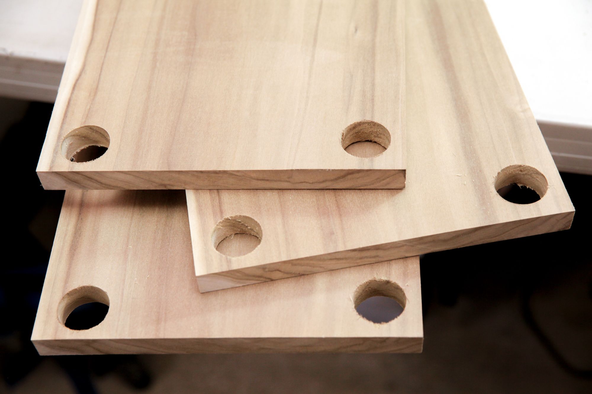

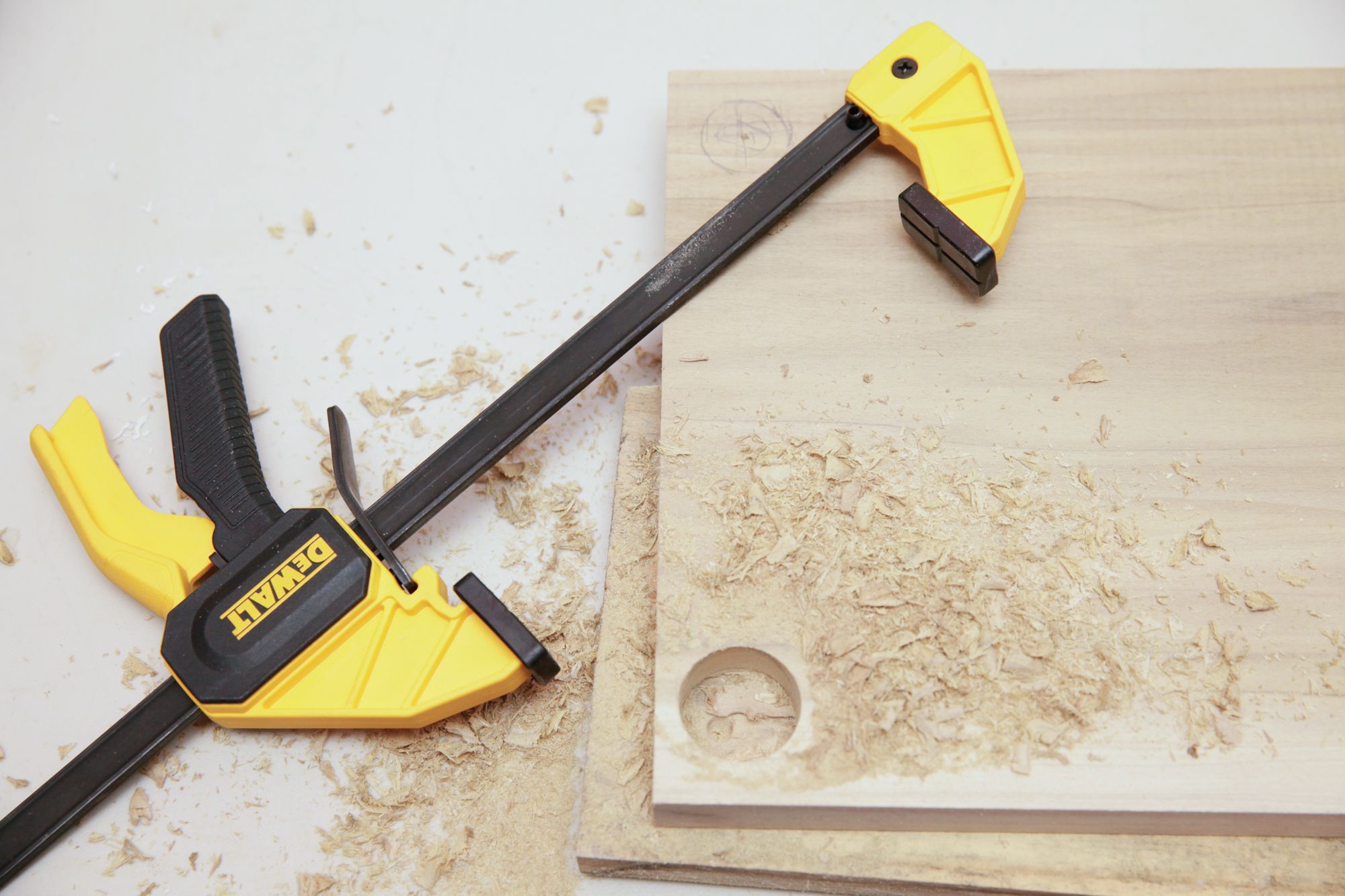

Cutting down a board is easy with a chop saw. I used a measuring tape and a square to make sure my cuts were the right length. If you don't have access to a chop saw (I don't, I used a friend's) ask the folks at the lumber yard to cut the wood down for you. Or use the tool of your choice! You have lots of options when it comes to making cuts in wood.
Measuring 1/2" from the side and corners, I marked out where I wanted to place the holes that the pipe would run through. Using a 1 1/4" spade bit, the holes were drilled. Ideally, you would use a drill press for this, but I just used my regular drill/driver and a piece of sacrificial board underneath.
Clean up the board with some 220 grit sandpaper on a sanding block before sealing. I prefer to use Matte Clear enamel, it really allows the wood grain to shine and yields a deep natural color.
