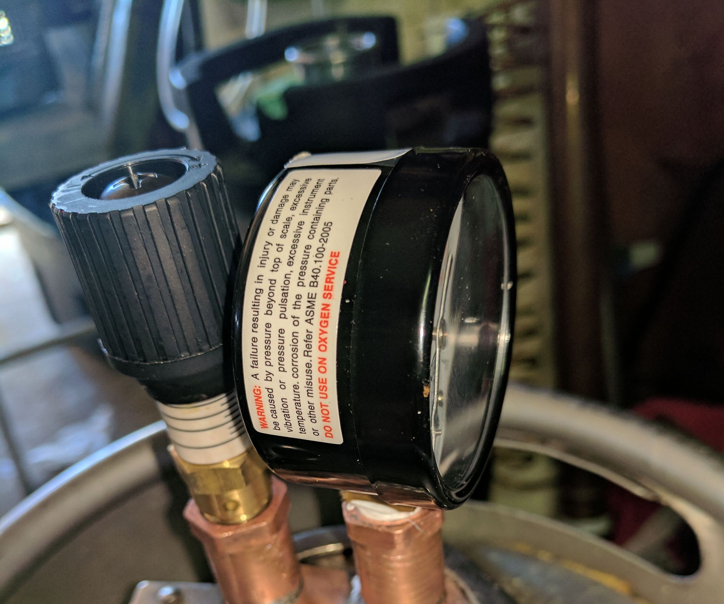

slide your shanks through. I drilled 7/8" holes for mine so I mostly had to thread mine through. tighten them down. mount the manifold through the holes you drilled earlier.
connect all your hoses and lines from the shanks, couplers, manifold, regulator etc. make sure its all tight. then go through making sure everything is tighter, and that you have gaskets everywhere you should.
tighten it all again.
seriously, you have a leak. find it, tighten it down.
turn your gas on and pressurise each line one at a time checking for leaks. remember. you probably have a leak, and you need to find it before you empty your CO2 tank.
if you haven't found at least one leak, you are probably missing something. try spraying each connection with star san or windex, and looking for bubbles. turning the gas up before you do this will often help.
