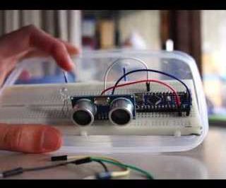

The picture above is the electric circuit of my pump system. You can ignore the distance sensor HC-SR04 and LEDs. They are just something extras for my house. If you are interested in why I've used the distance sensor and LEDs, please read my other Instructable: https://www.instructables.com/id/Make-a-Contactles...
