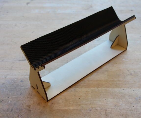

The pedal is mechanic and is very simple to make.
Step 1: STEP 1: Materials & Tools (CLAMP)
TOOLS:
  • Sawing machine
  • Sanding machine
  • Double-sided tape
  • A pair of siccors
  • Screwdriver
MATERIALS:
  • Multiplex plate minimum size: 500x240 mm (thickness = 10 mm)
  • Iron rod 620 x diameter 10
  • Anti slip material
  • 16x screws ISO 7050 (13 x 2,9 )
  • 4x corner pieces metal
Step 2: STEP 2: Sawing of the Parts
NEEDED:
  • Sawing machine
  • Sanding machine
  • Multiplex plate minimum size: 500x240 mm (thickness=10 mm)
WHAT TO DO?
  1. Saw the plate in the right dimensions
  2. Round the corners with the sanding machine
Step 3: STEP 3: Blend the Rod
NEEDED:
  • Metal folds
WHAT TO DO?
  1. Blend the rod in the right dimension
Step 4: STEP 4: Assemble the Parts
NEEDED:
  • All the parts of the pervious steps
WHAT TO DO?
  1. Fasten the corners to the side plates
  2. Fasten one side plate to the bottom plate
  3. Connect the iron rod between the side plates
  4. Fasten the other side plate to the bottom plate
Step 5: STEP 5: Cut the Anti Slip Material
NEEDED:
  • A pair of scissors
WHAT TO DO?
  1. Take the anti slip material and draw the shape (given on the picture) at the antislip material.
  2. Cut the anti slip material.
Step 6: STEP 6: Glue the Anti Slip Material to the Assembly
NEEDED:
  • Assembly of STEP 4
  • Cutted parts of STEP 5
  • Double-sided tape
WHAT TO DO?
  1. Place double-sided tape on the bottom plate of the assembly of STEP 4, on the side shown on the picture.
  2. Add the anti slip material on the double-sided tape.
