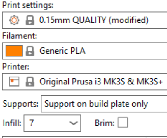

Step 2: Printing the Frame and Holder
We remade our version of GreatScott's frame and cuboid CAD models on Autodesk Fusion 360, making sure we adjusted the screw holes to accommodate M3 screws and nuts. GreatScott's models can be found in his Instructable. The attached .3mf files are the models we made and printed.
Print settings we used:
This took about 6 hours to print.

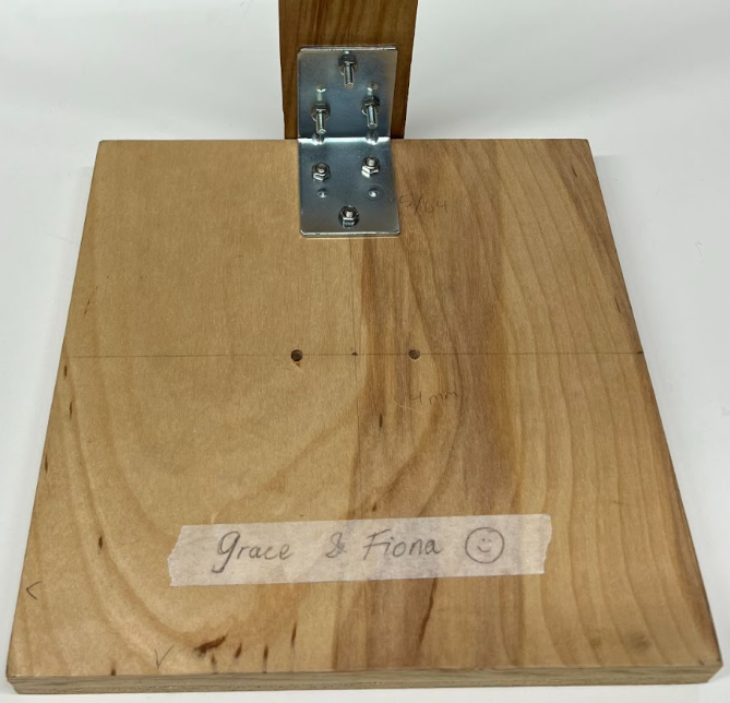

Step 4: Drilling the Wood
Marking:
  1. To find the center point of the bottom plate and side piece, we marked the midpoints of each side to draw a line connecting one side to the other. Then, once the midpoints from one side to another are connected, the intersection created by the two lines indicates the center of the wood piece.
  2. Then, we marked two dots from the center point to indicate where the position of the screws for the motor. For us, each screw was 20.5mm away from the center.
  3. We placed the side piece vertically against the side of the base plate and lined up the center line of the side piece with the center line of the bottom plate.
  4. Then, we placed the corner bracket at the intersection and marked the screw holes on both the bottom plate and side piece.
  5. We repeated steps 3-4 with the top piece and side piece.

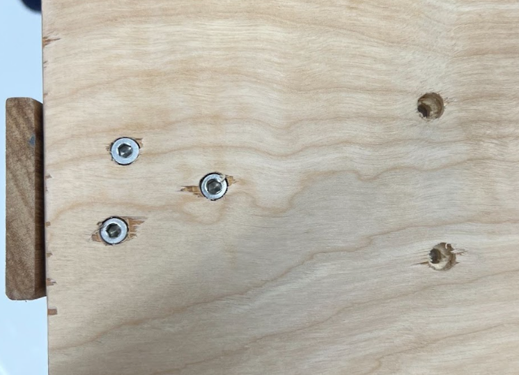

Drilling:
  1. We used a 4mm drill bit to drill through all the marked spots.
  2. We made sure to accommodate the screw head at the bottom of the base plate and drill into the wood according to the head type of the screw used for the motor. To do this, we created a counterbore hole by drilling as deep as the height of the screw head and used a drill bit a little bit wider than the screw head. (TIP: use progressively larger drill bits to avoid splintering the wood when drilling larger holes.) (Note: Now would be the best time to paint the wood, which we did later in the process, which ended up more troublesome than if we had done it after cutting and drilling the holes.)
  3. Then, we screwed the corner bracket into the base and side wood piece.

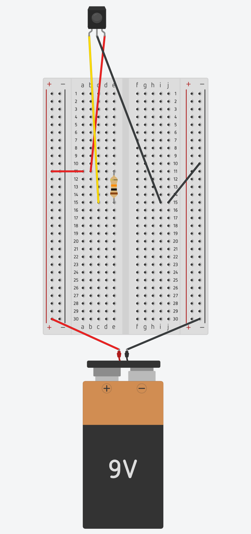

Step 9: Hall Effect Sensor
The Hall effect sensor was integral to this build and it was of utmost importance that the Hall effect sensor worked as expected for any of the Arduino code to work. Fortunately, it was relatively simple.
The first thing we did was solder three wires onto the Hall effect sensor to extend its prongs. They are color-coded in the picture: blue is power; white is ground; yellow is data.
We decided to use a breadboard to minimize mistakes before soldering anything together.
  1. We put the Hall effect sensor somewhere on the breadboard.
  2. Connected a 10k Ohm resistor to the power wire and the data wire of the sensor. They were placed on different rows.
  3. The sensor's ground wire was on the other side of the breadboard.
  4. We connected the circuit to power. Power should go into the power wire of the sensor and out of the ground wire.
  5. Now we tested it. Using a multimeter, we measured the voltage across the data and power wires of the sensor as a magnet closely passed by the tapered side of the sensor. The multimeter read 5V as the magnet passed, then immediately reset to 0V once the magnet was no longer nearby the sensor.
Note: TinkerCAD has no Hall effect sensor available for use, so the provided TinkerCAD screenshot is simply a visual guide to accompany the breadboard picture. In the screenshot, power is red, data is yellow, and ground is black.
Now that the circuit was tested to work properly, we soldered it together and glued it on!

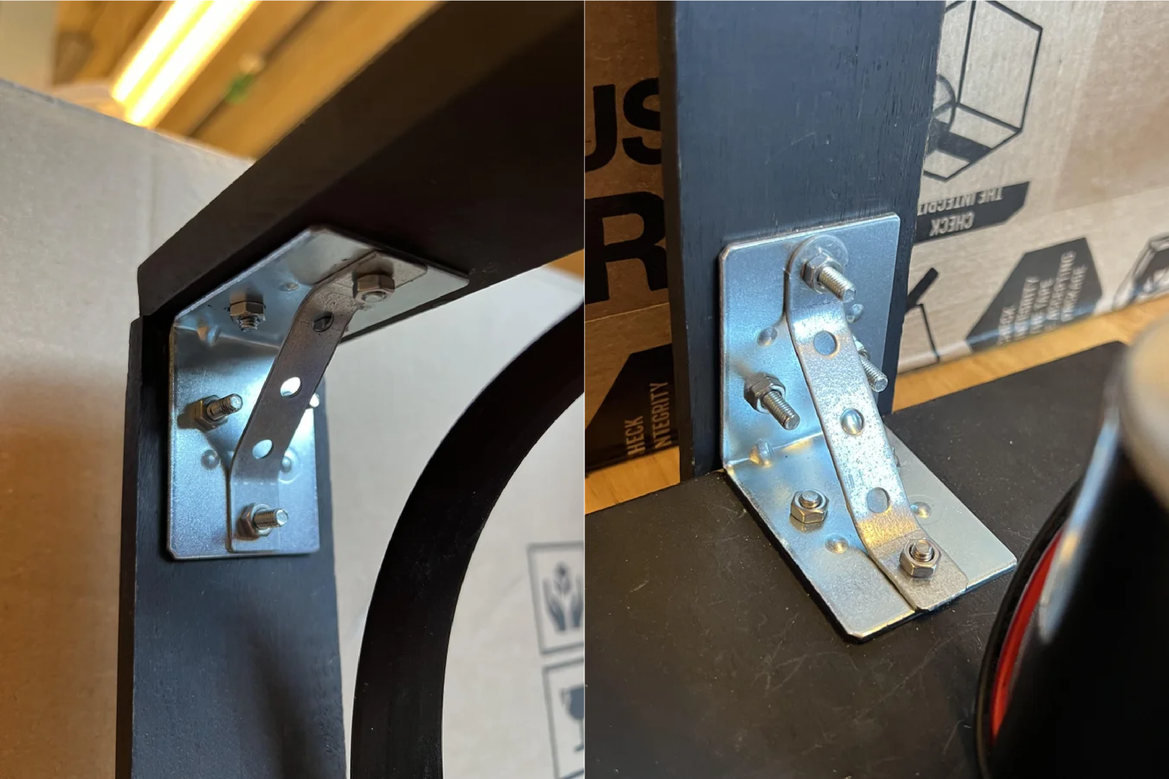

  • A lot of vibration is caused because the globe was not equal in weight on both sides. Because the Hall effect sensor weighs less than the LED strip, we measured the difference in weight, and then used fan balancing weights to compensate for the difference in weight.
  • There was still quite a bit of vibration in the base, so we cut and bent two VEX steel bars to form a triangle at the corner brackets.
  • However, it still shook a little, so we plan to add a large weight to the wooden base in the future.
  • We recut a new top piece for we opted to use a thicker cut of wood.
  • If you do the same, try to use one ball bearing despite its ugliness; we found it became extremely difficult to avoid friction on the steel pole and it slowed the motor down with more ball bearings.
