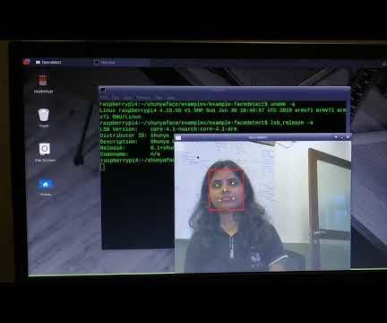

Step 1: Preparing the Raspberry Pi 4
Install Shunya OS on Raspberry Pi 4
Shunya OS is an operating system like Android or Raspbian which runs on devices like Raspberry Pi, Orange Pi, Tinker board, etc.
1) Download Shunya OS from the official release site
2) Load Shunya OS on the SD-card using the steps given below:
  1. Right-click on the zip file downloaded and select Extract here
  2. Once the file is extracted double click on the extracted folder in which you will find the image file (OS file) and release info.
  3. Right-click on the image file(.img file)
  4. Select Open with -> Disk image writer
  5. Choose Destination as SD Card Reader
  6. Enter your password this will start loading the SD-card with Shunya OS. Be patient and wait for the process to complete (100%)
3) Insert micro SD card into Raspberry Pi 4.
4) Connect mouse & keyboard to Raspberry Pi 4.
5) Connect Monitor to Raspberry Pi 4 via micro-HDMI
6) Connect the power cable and Power ON the Raspberry Pi 4.
The Raspberry Pi 4 should boot up with Shunya OS. After the OS boots up you should see a login screen.
Here are the login details:
Username: shunya
Password: shunya
