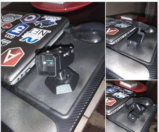

Step 1: 3D Printed Case
The case is 3D printed. This step is optional but recommended as it protects your pi zero and creates a nice finished looking project. First you will need to head over to thingiverse and download the STL files i designed for the case. There are 2 files available. One includes a window for the OLED display and the other does not in case you want to skip the optional OLED display
https://www.thingiverse.com/thing:2988969
Download the STL file(s) and load them into your slicer of choice. I use Cura because its free and does a good enough job for me. After loading the STL set your slicer to the highest quality settings your printer can support. Export the gcode files and send them to your 3D printer.
Step 2: Assembly
- Connect and solder OLED i2c interface
https://circuitdigest.com/microcontroller-projects... - Connect and solder USB data and power lines
- Put it all together
once the case is printed, you should be able to sandwich everything together. I used a dot of superglue on each corner post to ensure a good solid connection but depending on the quality of your printer you might not need this since the corner posts on the case are designed to clip lock on their own.
