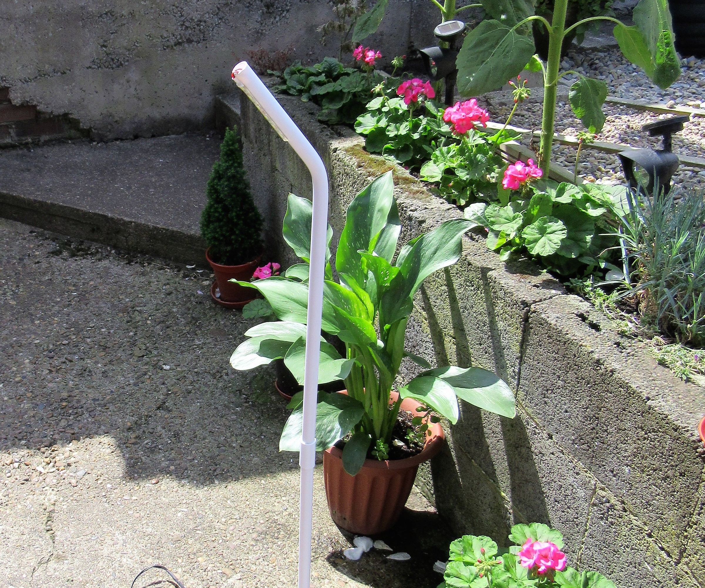

Last year 2016 I altered my garden and planted some new stock. Half way through the growing season I noticed that the right hand Carnation had grown far more vigorously than its twin only 20” away. The only differences to the plants was that a solar powered battery light had been placed by chance to shine directly down on the right hand plant.
I'm not sure why the three low powered LED's would have made such a marked difference but I am going to try and see if I can create the same effect in my failing greenhouse.

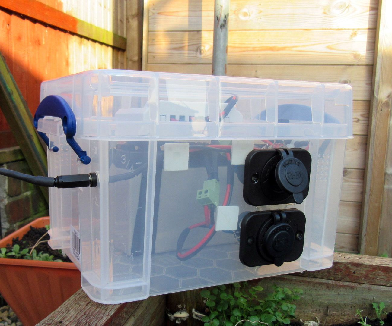

As I am powering this project with a solar powered 7ah battery I want to make sure that I am not wasting power so I have created three light “zones”.

I have used the supplied battery cable so I can use battery power if I remove the Picaxe from the main board but I will be using the regulated 5v from the power circuit board via the 2 pin connector normally.
