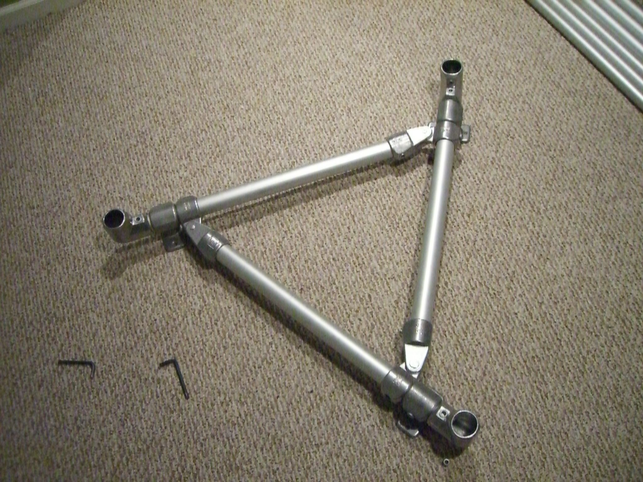

Step 1: Attach Flanges to Table Bottom
Really, this can be done by eye, but you could use a tape measure to determine how far from each of the four table corners you want your legs to be. One consideration is that the closer to the edge, the more legroom you will have. About 1-2" is good.
Make sure to use the appropriate length wood screw for the thickness of your tabletop... you don't want screws poking through the top of your table!
Pre-drill your holes and drive four wood screws into each Kee Klamp Flange, securing it to the underside of the table top.
Step 2: Attach Table Legs
Just slide each Pipe Leg into the Kee Klamp Flange and tighten using the allen key wrench.
