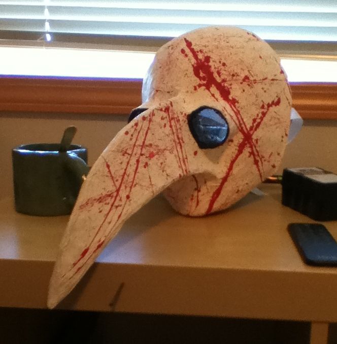

Step 2: Making the Beak.
The pieces for the beak were cut from a sheet of heavyweight paper and fixed together with the same gummed tape.
Once the joints were dry I built up about three layers of tape on the beak.
For the eyepieces/ goggles I covered a couple of small spice jars with cling film and built up a layer of gummed tape.
I did not photograph this part.
Step 3: Assembling the Parts.
You should now have the head, eye pieces and beak.
They can now be fixed together, again using gummed tape.
Start by applying the tape to the outside of the mask to hold the pieces in place.
Allow to dry.
Now add a layer of gummed tape to the inside of the mask, this will increase its rigidity,
It is worth doing this holding the mask up to a bright light so that you can reinforce thin patches.
Allow to dry.
At this stage I decided that I would give the mask surface a bit of texture using flexible decorators caulk.
This is cheap to buy and fairly quick drying.
I also cut the nostril slits in the beak and gave them a bit of shape with the caulk.
You can also add  the fixing elastic at this time, I stapled it to the inside of the mask and covered the exposed staples on the outside with caulk.
I allowed the caulk to dry overnight.
You can now paint the mask.
I used a cream coloured vinyl satin paint.
I painted the inside of the eye pieces black.
When the paint was dry I added the eye piece covers, these were made from expanded aluminium mesh that was sprayed gold and shaped round the jars that I used to form the eyepieces.
I attached the mesh by binding on with self amalgamating tape.
Total time to make the mask was about three and a half hours spread over four days.
Not sure of the cost as I had all the materials that I needed.
The same principle of using gummed tape can of course be used to construct other designs.
