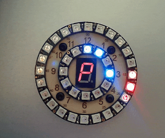

Again, for my project, the device to be programmed is the ATtiny85 microcontroller. Testing this requires connecting the other end of the 6 jumper wires to the appropriate holes of an Arduino as outlined in this instructable.
Here's a link to the particular board for which this pogo clip is intended. The connection points are on the bottom side of the board (Click "layers" and "bottom" to see them).
