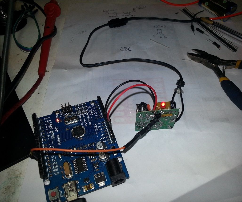

I am using Arduino Uno with Dual Stepper Motor Driver Shield (Bipolar) and bipolar stepper motor "mercury motor SM-42BYG011-25, printed some pulleys and gondola from http://www.thingiverse.com/

1- before loading software to arduino (polargraph_server_a1.ino) change constant in
“byte const PEN_HEIGHT_SERVO_PIN = 10;” in polargraph_server_a1 tab. Why? Because default pin 9 matches stepper shield pin "Y MS2 SETTING" figure below related to velocity which in our case is set by jumpers. Obviously signal pin of the servo now need to be connected to pin10.
2- For this specific stepper motor shield please change this in configuration tab:
#ifdef SERIAL_STEPPER_DRIVERS
#define MOTOR_A_ENABLE_PIN16 //// my note: pin A2 in dual stepper shield "ENX"
#define MOTOR_A_STEP_PIN 2
#define MOTOR_A_DIR_PIN 3
#define MOTOR_B_ENABLE_PIN 14 /// my note Pin A0 in dual stepper shield "ENY"
#define MOTOR_B_STEP_PIN 6
#define MOTOR_B_DIR_PIN 7
