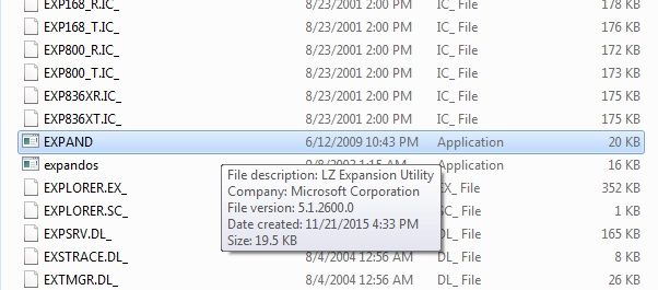

For people having a windows XP installation CD or its backup lying around you will find the files in the I386 subfolder as shown in the picture. Enter the folder to find the treasure. ;-)
Step 3: The Files in the I386 Folder
You will need 5 files
- EXPAND.EXE (microsoft expand utility for compressed files)
- HYPERTRM.CH_ (compressed version of hypertrm.chm)
- HYPERTRM.EX_ (compressed version of hypertrm.exe)
- HYPERTRM.DL_ (compressed version of hypertrm.dll)
- HYPERTRM.HL_ (compressed version of hypertrm.hlp)
Just copy all these in the newly created folder just for them (mine was "h:\hyperterminal")

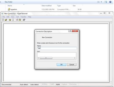

Just Click on the application's (Hypertrm.exe) icon and Tada... The computer will ask you your area code etc (keeps it somwhere may be in the registry so next time it won't ask) and to name your connection. I named it "test".
