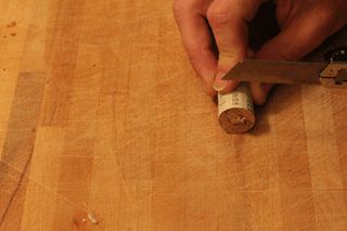

Take 8 corks and trim their length with the cutter knife if they would be longer then the frame's height. Warning : cutting a cork is not that easy, and so you need to be careful. I found that this works best : cut the cork as deep as you can, then roll the cork so it rotates about 45 degrees and cut again, repeat this until it is cut completely.
