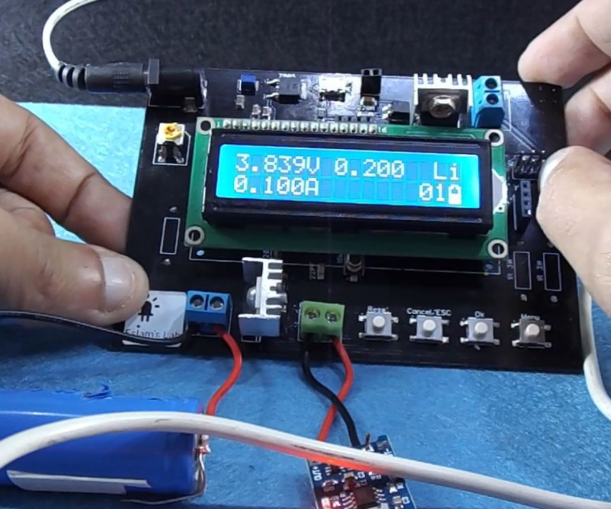

the first thing is tearing down that battery to salvage cells from inside
then measure each cell it should be higher than 3v
try to charge each cell and monitor it until it reach 4.2v with special li-ion charger
then try discharge and see if it can last long time.
