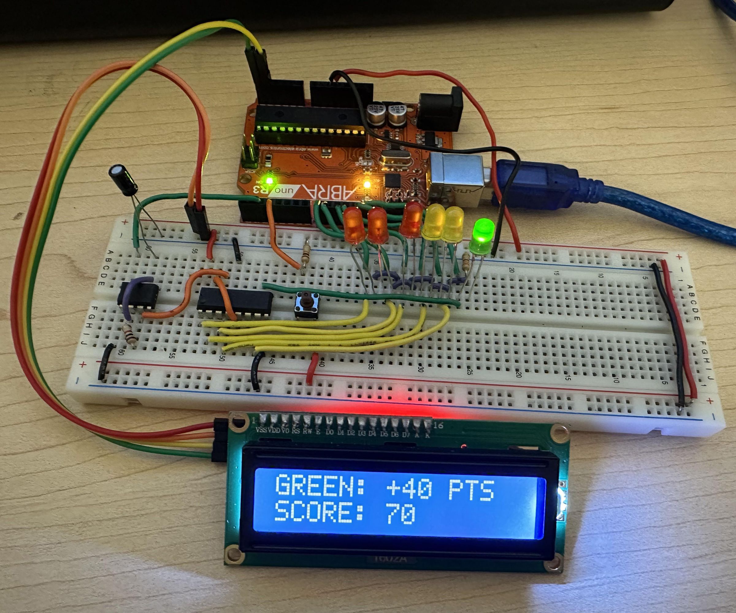

Hello, My name is Prabjyot Singh, and this is my practice metronome. I have made a metronome which can detect if you are actually sitting down and practicing your instrument. if you are not, the metronome will flash an led to catch your attention and to bring you back. The metronome has a green LED which displays the tempo, and a potentiometer which is used to change the tempo. It also has an on/off switch so that you can turn it off once you are done. Let's see how this circuit is made.

Step 1: Start Building Circuit on Breadboard
For the first step, start placing components into your breadboard. You can copy the placements on my breadboard, or see the next instructions. Make sure to connect these components to the ground and power rails correctly, and using resistors when needed. The distance sensor and the sound sensor should be facing the user. The potentiometer and slide switch should be easily accessible and in a different location than the input components. The leds should be in a highly visible place.
Step 2: Wiring Up With the Arduino
Connect up all of these components with the Arduino. Connect up the power and ground rails on the breadboard to the 5V power and GND ground pins of the Arduino. The potentiometer and the sound sensor are analog input devices, so they must be connected to analog input pins. The rest of the components are digital inputs and outputs so they can be connected to digital pins.

Step 5: Finished Project
the finished project is the practice metronome. To turn it on, simply switch the on/off switch into the on position and start playing an instrument while sitting relatively close to it.
