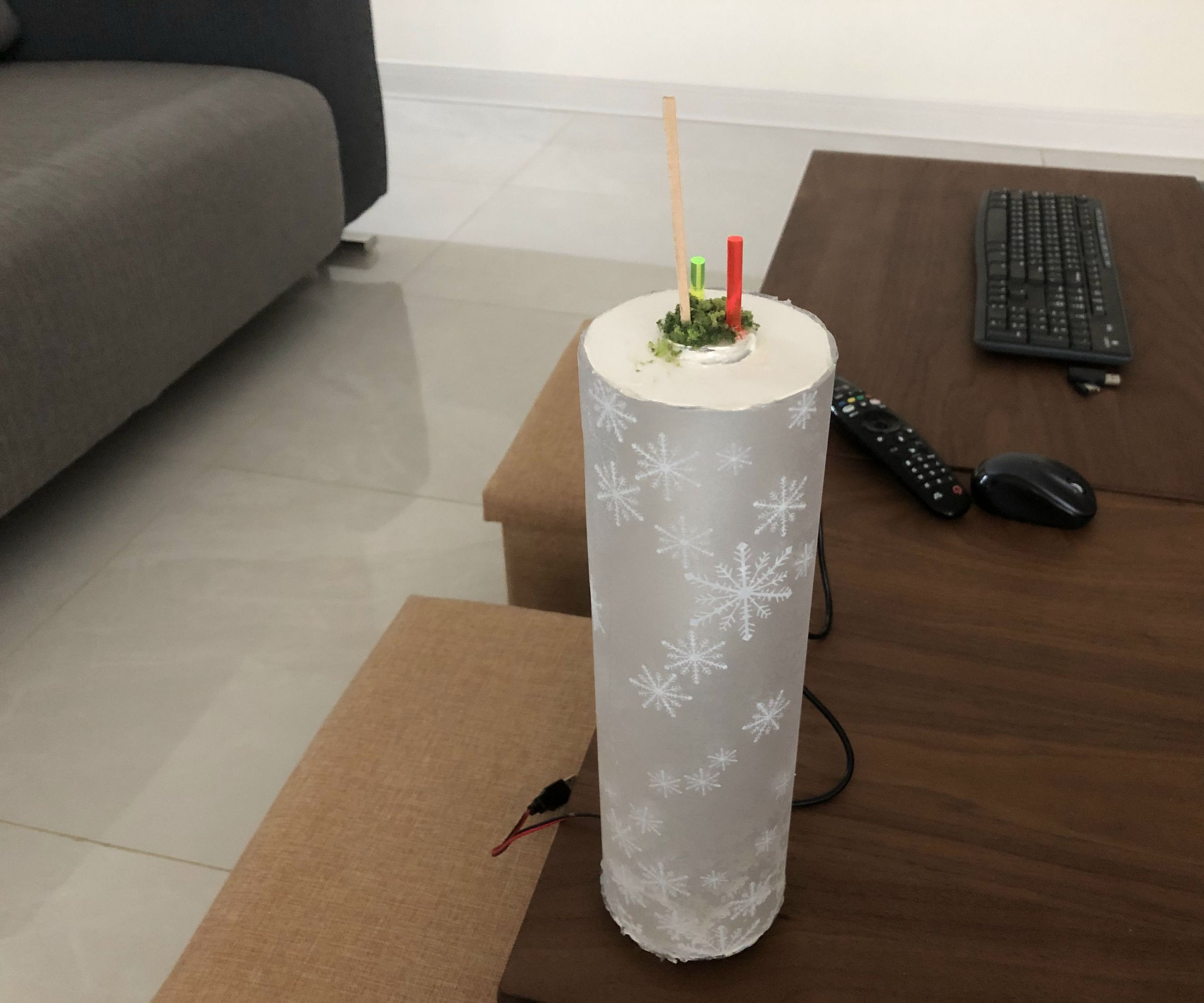

Introduction: Presentation Magic Wand With Arduino
This device is intended to be used in a presentation to extend the presenter's access to the computer utilities without directly control the computer using a mouse or a keyboard. By swiping the magic wand in many different ways, the presenter is able to toggle a computer's workspace (screens), switch presentation pages, and execute up to two customized system commands. It also draws interest from the audience and creates fun.
