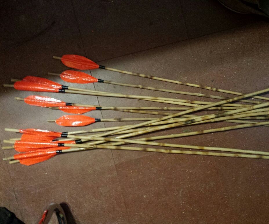

Step 2: Measure Arrows to Determine Quiver Length.
It is very important to measure arrow length prior to cutting the leather. Remember this motto: Measure twice, cut once!! My friend said that he wanted a Plains style quiver that came to halfway of the fletching. The arrows were about 31 inches so I decided to go with a 29" length of the main compartment. I allowed for 3 additional inches to form the rolled back leather "collar" in the front.
