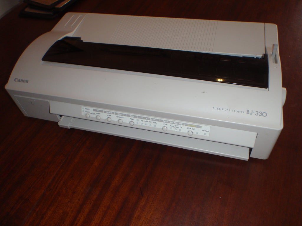

STEP 2: Checking Out the Printer
Of course you will also need a printer, an old one with stepper motors driving the roller and the slide. I pick up this old cannon A2 printer off ebay for $5. Back in the day it would of been worth $2000-$3000. Before I got to carried away striping the printer down I spent a few days thinking about what needed to be removed and what I could keep. First I removed the plastic cover and studied the internals of the printer, I printed a few pages and tried to get a good understanding on how everything works.
The covers came off quite easily just a knob on the side and a few clips and it all came apart.
If your not sure if you have stepper motors or normal dc motors they are quite easy to identify, steppers have 4 or more wires coming out the back and they are  usually quite a large diameter and short. So look for short and fat motors with 4 wires.

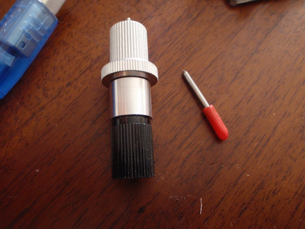

STEP 12: Fitting the Cutter
As with the electromagnet,  this part was also very time consuming and fiddly. I used a 3D printer to make a holder for the cutter and also some little brackets to hold the tube and spring from a ball point pen. The idea of the pen spring is to lift the cutter off the vinyl when the magnet is not energized,
Again everything has to be aligned perfectly and the spring tension has to be just right so the cutter moves away from the vinyl but not so far that the electromagnet is unable to pull it back.
I made an interesting discovery, that is I placed a button rare earth magnet on the back of the electromagnet it made the electromagnet much stronger and work more reliably. (This is a bit hard to see in the photo I've put a note box  on the photo with the yellow vinyl)
I then used the rapid fix glue to fasten everything down.
I also found that as the printer has a couple of gears in the mechanism, the tiny amount of backlash they  have, was causing some of the cuts not to join up by about 1/2 a mm. Very annoying when you go to remove the wast from the sticker, so I will move the stepper motor so it directly drives the roller.

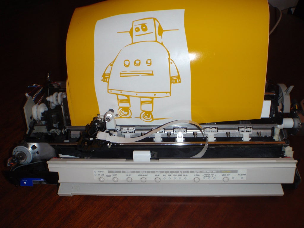

STEP 13: Work Flow
To put a drawing on the vinyl cutter is a bit of a process, and not all drawings are suitable to turn into a sign or sticker. Cartoons or block letters work best and the file cannot be too small or pixelation will cause issues.
The Screen shot have notes.
  • Open up Inkscape and click on file/ document properties
  • Next change the default units from px to mm you need to do this in 2 places
  • Now File / Import your drawing and select the drawing you want
  • A box will pop up just click ok
  • Your image should appear on the page and can be moved or re-sized The cutter starts from the lower left corner so you want to make sure its moved close to that point
  • Under the path tab click on trace bitmap
  • A pop up box with lots of settings to play with will appear click on update and ok when you are finished. The image should be made of  solid blacks lines when finished.
  • When you go back to your image on the page it looks like nothing happened, drag the trace off the top of the original image
  • Now delete the original image and move it to where you want on the page (macs have no delete key use control delete)
  • Now under path click on object to path
  • click on extensions Laserengraver
  • In the pop up box make sure the Directory path is correct and click on the laser tab
  • Turn the speed up to 1000 but dont click on apply yet. There is a glitch here that cause an error if the laser tab is open
  • Click on preferences again now hit apply
  • You should get a laser working box and a Gcode will appear on you desk top
  • If you would like to the workings of a Gcode you can open it with text edit
  • Open up Grbl and click on choose file and find your Ggode
  • You will now be able to see your tool path
  • Once you click on "begin", the machine will start working, you can follow the tools progress with the red dot and green lines on the screen
