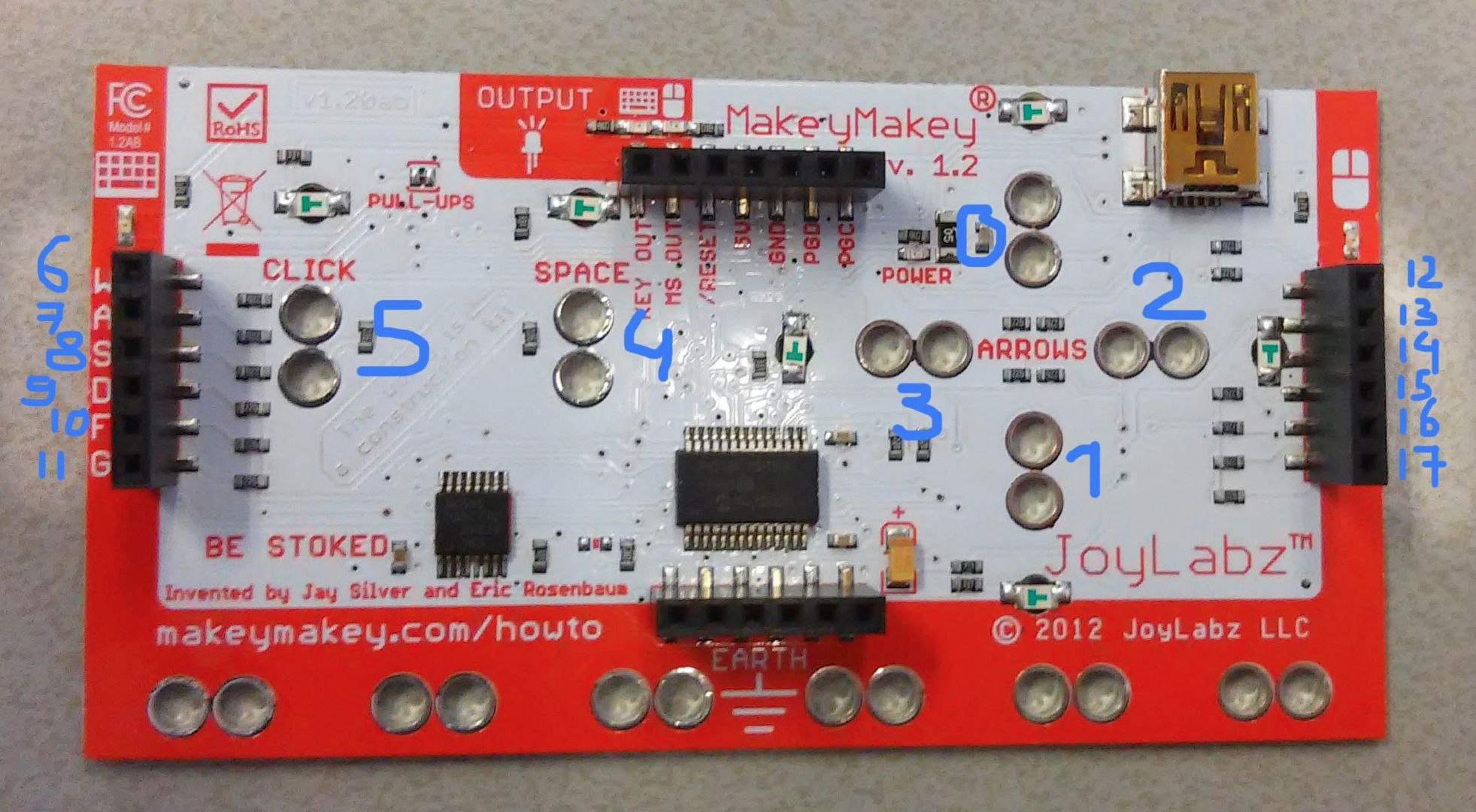

The first variable in this code is keyCodes[NUM_INPUTS]. This variable is an array that contains 18 values. Each value stands for a key or mouse input and has its own index. So KEY_UP_ARROW is index 0, KEY_DOWN_ARROW is index 1 and so on. These index numbers match with the MaKey MaKey inputs on the board.
At the bottom of the code you can find a list of additional key codes. You can use these codes to change the key mapping of the MaKey MaKey.
Let's say you want to change the SPACE key to an ENTER key. This is index 4 as you can see on the image. Search for index 4 in the code and change ' ' to KEY_RETURN.
