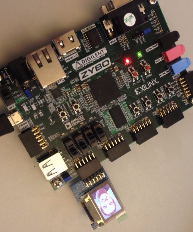

Step 7: Displaying a Bitmap Part 1
Displaying a bitmap using the OLEDrgb library requires us to first turn it into a byte array. I created a python script that does this, but first we need a bitmap.
Open paint and click on Resize. Resize the image to 96 pixels horizontal by 64 pixels vertical.
Let your imagination run wild. When you are finished, save the image as a 24-bit bitmap.
Copy the bitmaptoarray.py script into the same folder as your masterpiece and run it. When prompted, enter the name of your bitmap file and press enter. If it worked you should see "Byte array created as masterpiecearray.c!" Within your folder, you should see a new .c file that contains your array.
Step 8: Displaying a Bitmap Part 2
Copy and paste the array into your MPIDE sketch above the setup() function.
Now, inside of you setup() function, but after OLEDrgb.begin() copy the following line into your code
OLEDrgb.DrawBitmap(0,0,95,63, (uint8_t*)masterpiece);
This will draw your masterpiece array from (0,0) to (95, 63) when your program is run.
Click Upload to program your board. You should eventually see your masterpiece on the PmodOLEDrgb!
