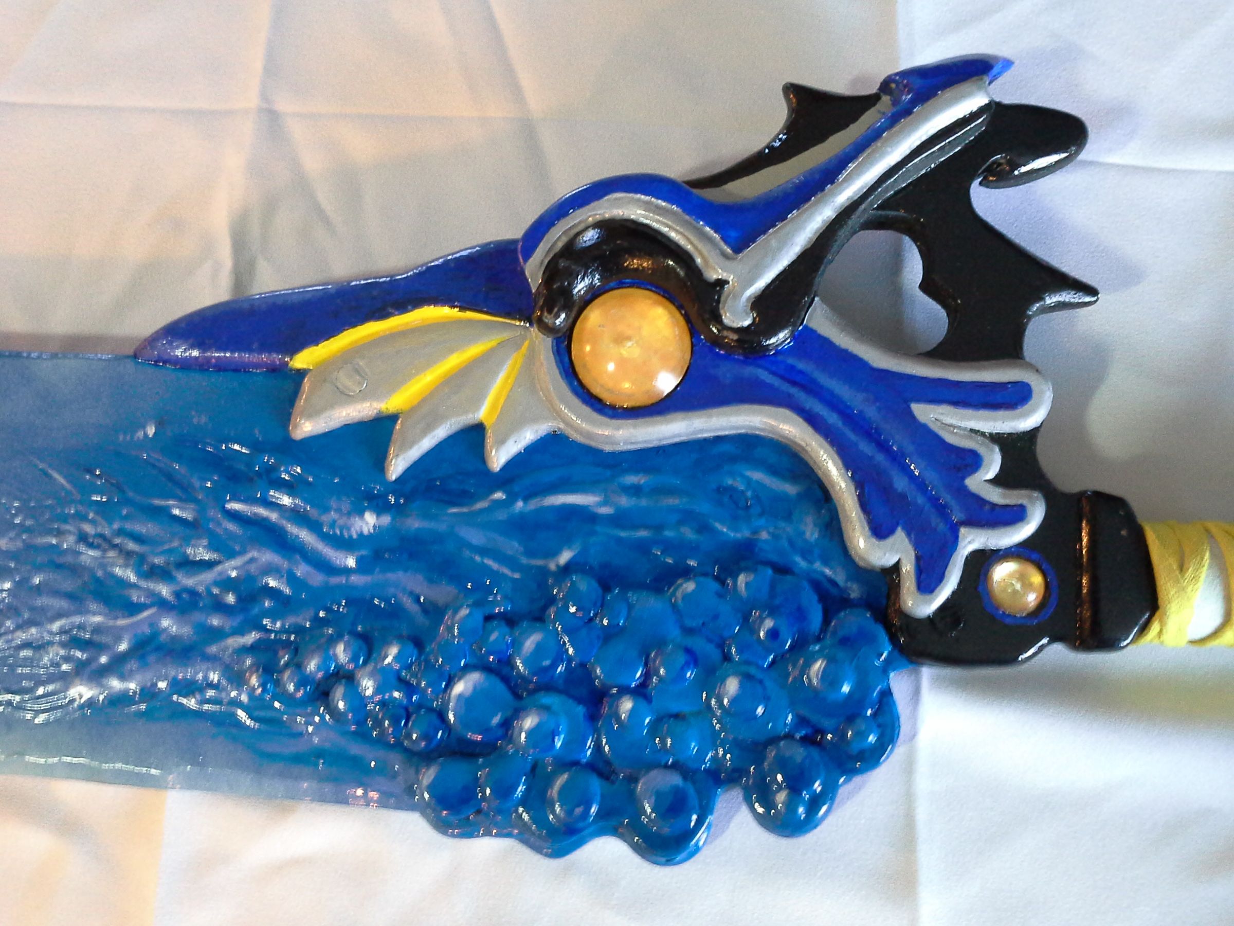

Step 6: Bubbles!
This is where the Instructable diverges slighty, but you might find it fun anyhow.
Not everything can be made with MDF. Making props is an adventure of combining all kinds of different materials. Brotherhood's blade is supposed to be made of water. Originally I wanted to make it out of clear acrylic but time and money were an issue. I still didn't want the blade to be purely flat. Especially when you look at the CGI reference, there's a lot going on with those bubbles near the base. I wanted them to look very 3D.
So I cut out a piece of card stock in the shape of the base on both sides. Then using hot glue I began to layer it up. Hot glue has a bad tendency to melt though, when left in the sun, so I wanted the bubbles made out of something more durable. So I created simple silicone impression molds and pressed Friendly Plastic into them. In retrospect this was a mistake. The Friendly Plastic has a tendency to curl up slightly after cooling. Resin would have been more effective. Oh well. With epoxy and another army of clamps I was able to secure them to the blade.
Step 7: Waves!
Bubbles aren't enough, though! The rest of the blade still looked flat. The easiest solution with what I had on hand was epoxy resin. Mix some of this stuff up and spread it across the surface of the blade in a somewhat "shooting waters" pattern, let set, repeat a couple of times, layering, and you get a somewhat watery texture across the flat of the blade. This is also where I got the idea to coat the tip of the blade in epoxy resin. This keeps the thin MDF from splitting and degrading over time when the weapon is resting on the tip. It's a practice I now use on every MDF prop.
Oh, by the way, the hole in the handle that sort of look like eyes were to accommodate wiring for the light up gems that would be inset there later. There are no photos of this, but the handle has channels inside for the wiring to move through. Why do they light up? They don't do it in the game, you say? Uh... Why not? Lights are always cool, right!?
Right. Moving on.
Right. Moving on.
Step 8: Painting
Finally the home stretch!
Start out by giving your piece a primer coat. The color is your choice really, but I tend to operate on a simple pair of rules. If your piece is primarily chromatic colors, use white as your base. Your colors will come out much brighter on top of a white base. If the project is primarily metallic, use black. Metallic colors show up better on a black base and if your prop gets scratched it will merely look like battle damage. It also makes metallic props easier to weather in the long run.
After the primer coats and some sanding, I applied two blues. The deeper blue started near the handle and faded out just a little past the halfway point of the blade. The light blue started at the tip and I sprayed a gradient just past the edge of the darker blue. After this, everything was hand painted. The blade in particular got a variety of darker washes and then some dry brushing of whites and light blue greens over the top.
