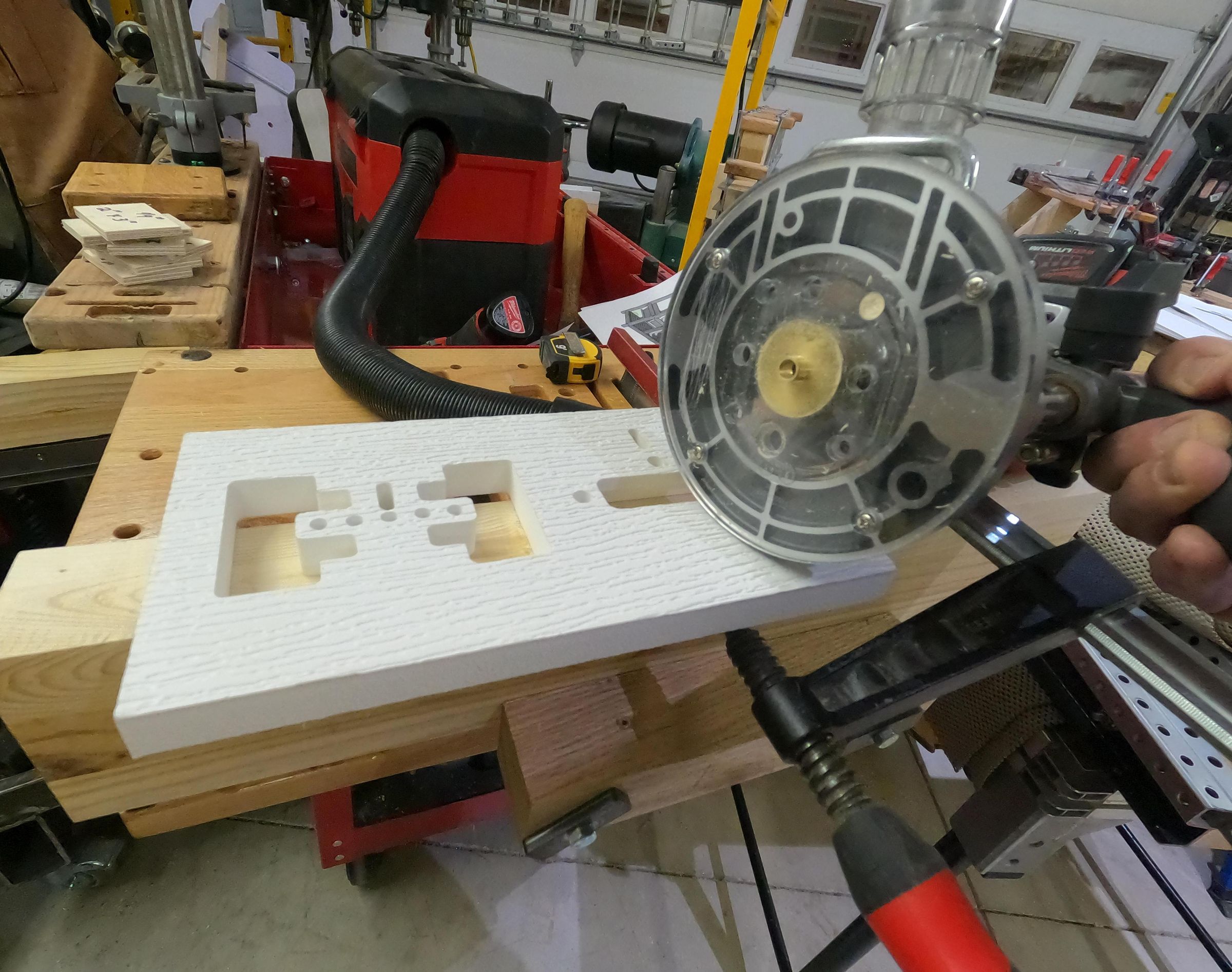

  • Joinery Mortises Template: A PVC Template was used to demonstrate two methods to create the 3/8" deep mortise for Threaded Tenons
  • The first method used multiple 1/4" diameter holes CNC placed on the PVC template to insert a Snappy 7/64 O.D, Self Centering Hinge Bit to "dimple" for a Forstner bit. This method of mortising is demonstrated below.
  • The second method used a rectangular shaped cavity on the same Template to guide a 1/4" upspiral solid carbide router bit to create a rectangular shaped 3/8" deep mortise to accommodate the goofy-looking overlapped-circle laser fabricated threaded metal tenons. This method for mortising is also demonstrated in Phase 3: Joinery
  • When viewing the video note how there is literally NO DUST from the mortise routing. This is because of a very unique method of making the router template, one I hope to someday do an Instructable on. A "dust pocket" is created 1/2" deep and about 3/8" wider than the surface the router guide bushing rides on. s

The initial intent was for these two Posts to be "prototypes" for demonstrating how different sizes and shaped MikroRails (coming soon) connect. But the posts turned out so nicely that I didn't have the heart to mortise multiple cavities for the different MikroRail applications. Instead I decided these two Posts will become part of a future Instructable, TBD, probably as the two Posts at the foot of a Farm-Style Rustic Oak Bed.
One of the MikroRail prototypes was getting close to what could be the Side Rails of the bed and/or the Footboard. That prototype was 12" high so only one Threaded Metal Tenon on each end would be plenty. If that mortise was located at the center of each Post then these MikroPosts could be used for both demonstration and then later for the real thing.
With this in mind I created a single mortise in each post BUT using two different methods resulting in two different shapes.
  1. A rectangular mortise 3/8" deep x 3/4" wide x 3" high created with a hand-held Milwaukee 18V router with a guide bushing using a CNC routed PVC template. This method demonstrates how woodworkers familiar with routing can make the shallow mortises.
  2. To demonstrate how non-routing folks can create similar mortises using a Forstner Bit the same template was used to punch 3 "dimples" with a "Hinge Bit" to provide a contact point for the sharp point on a 3/4" Forstner bit to bore 3 overlapping circles to 3/8" deep.
Both methods take only a few minutes and are equally as effective. The video demonstrates how different shapes of threaded tenons will react to the two shapes of the mortises requiring a few taps of a hand chisel to adapt.
Using the Dual Method PVC Templates
The PVC Template created on a CNC router serves either of the methods. In both cases the template has two slots at 4 1/2" apart. Placing a 1/4" piece of plywood in each of those strips allows the Template to slide over a 4 1/2" Post.
The Forstner Bit Mortising Method
  • One section of the Template has five 1/4" holes. A 7/64" Snappy Self-Centering Hinge Bit mounted in the chuck of a 12V Milwaukee Driver was used in each hole to create a "dimple"
  • The jig was removed then the Post placed on the table of an 8" Wen Benchtop Drillpress table where the sharp pointed tip of the 11/16" Forstner was steered into position via the dimples.
  • All three holes were drilled relying on the depth stop to 3/8" depth
  • The Post was removed from the Drill Press
  • If a drillpress is not available a hand-held drill, not as accurate, will do the trick
The Router Mortising Method
  • A different section, an area with a full-thru rectangle, but on the same Template was mounted using the same plywood grabbers. In this case, because a router will push the Template from side to side during routing, a Bessey Clamp was used to snug the Template to the Post but well out of the way of the router bit.
  • A 1/4" upspiral router and matching guide bushing mounted in a Milwaukee 18V router connected to a Milwaukee 18V vac was used to follow the pattern on the Template to create a mortise.
  • Each pass was set to 1/8" deep so three passes were made using the turret depth set of the router
  • When the Template was removed there was not a spec of dust! Some of this had to do with the great dust collection system integrated into the Milwaukee router but another was not quite so obvious. This little trick to making router templates works wonders and, hopefully, will be the subject of another Instructable in the future.

Creating Mortises Using a Router with Template and Template Guide
This method can easily be done with a hand-held router.
  • I use a Milwaukee 18V with their optional Plunge Base.
  • The PVC template for this step is the same template used for the mounting of tenons, as shown in previous Steps
  • The router is equipped with a 1/4" Upspiral Solid Carbide router bit
  • The router is equipped with a template guide bushing to match
  • An 18V Milwaukee shop vac is used attached to the Plunge Base
This router method, once one gets used to routing this way, is so slick and, using the Milwaukee plunge base connected to the vac and a very special custom-made template (it has a hidden "dust pocket below the surface) makes this a virtually dust-free process. Not a spec of dust! The mortises are absolutely perfect in three passes at 1/8" per pass
Video: Using a Router To Create Mortises for Threaded Tenon Joinery
