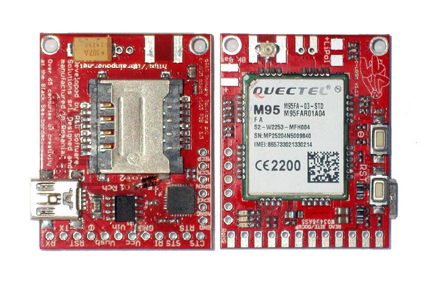

- 1pcs. x g-SPS 5V version switching power supply
- 1pcs. x 2.1mm/2.5mm barrel power jack (choose one that fits with your wall adapter) or see "Barrel jack alternative" and g-SPS reference later
- 1pcs. x 3 pins standard 0.1"/2.54mm row-header 90 degrees or straight
- connecting wires x2
