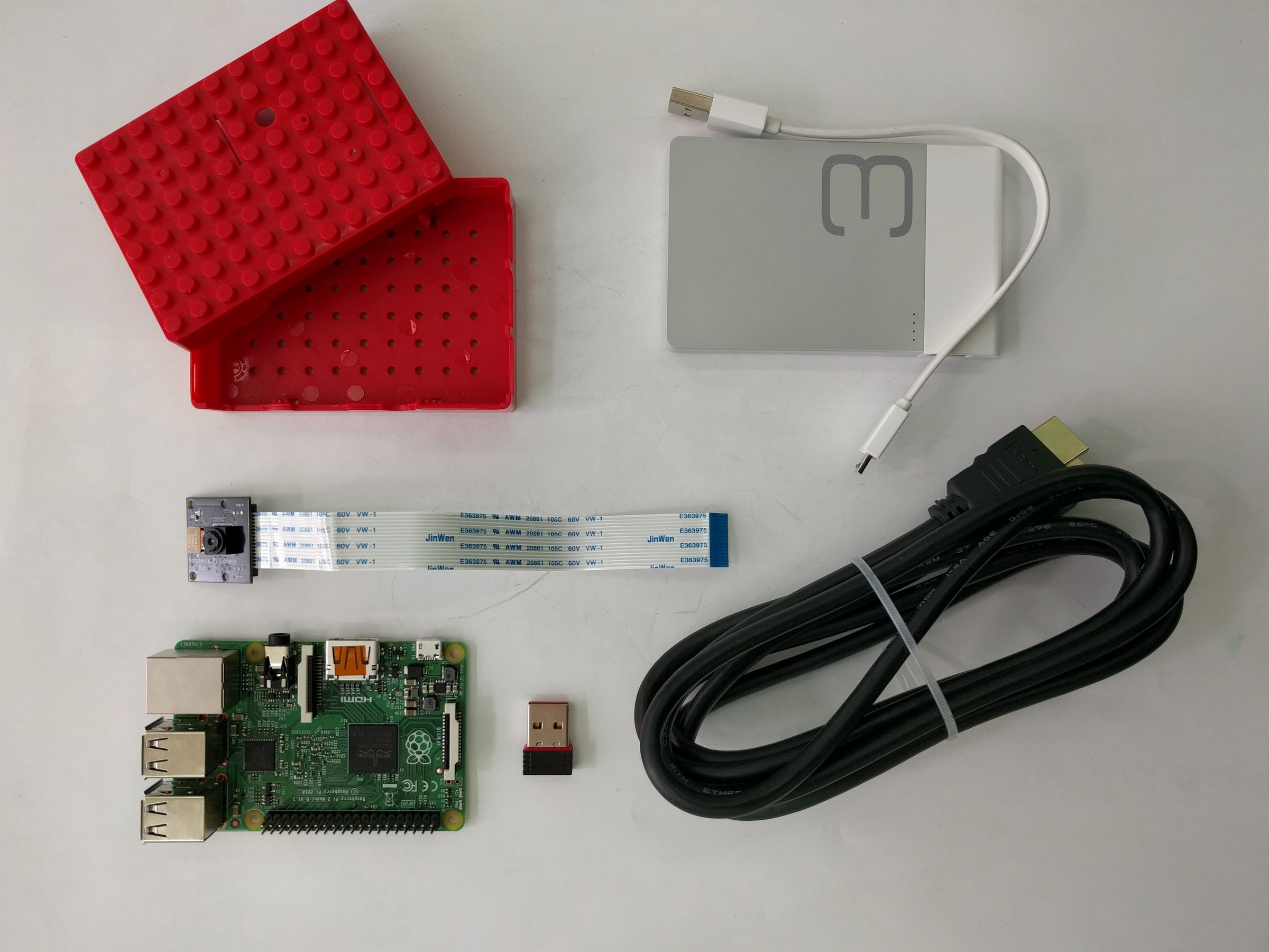

Step 1: Supplies
For the project you need:
1. MathWorks MATLAB
MATLAB (matrix laboratory) is a multi-paradigm numerical computing environment and fourth-generation programming language. A proprietary programming language developed by MathWorks, MATLAB allows matrix manipulations, plotting of functions and data, implementation of algorithms, creation of user interfaces, and interfacing with programs written in other languages, including C, C++, Java, Fortran and Python. It features some useful libraries for image processing like Computer Vision Toolbox, Image Processing Toolbox and Image Acquisition Toolbox.
2. Raspberry Pi 2 model B
Raspberry Pi 2 packs up a 900MHz quad-core ARM Cortex-A7 CPU, VideoCore IV 3D graphics core and 1GB RAM. It can run a full range of ARM GNU/Linux distributions, including Snappy Ubuntu Core, as well as Microsoft Windows 10 (We tried Raspberry Pi A+ model too, and it worked!).
3. Raspberry Pi case
Nothing to write home about, really. Just an ordinary housing! (Mind the place for mounting a camera - not every housing has it!)
4. Raspberry Pi Camera Board
Raspberry Pi Camera Board uses a 5-Mpx CMOS OmniVision 5647 sensor with the resolution of 2592x1944 pixels. It supports 1080p30 and 720p60. The Pi NoIR gives you everything a regular camera module offers, with one difference: it does not employ an infrared filter. (NoIR = No Infrared.) This means that pictures you take in the daylight look decidedly curious, but when fitted with infrared lighting it allows you to see in the dark.
5. Power supply
We are using Huawei Power Bank (2000 mAh), but you can use any power source suitable for Raspberry Pi 2 Model B (mind that it should be rated for at least 700mA/5V).
6. WiFi Dongle
Use any dongle that supports 802.11n/g/b standards.
7. SD card
4GB or more.
8. HDMI cable
An ordinary HDMI cable is suitable for connection with Raspberry Pi 2 Model B (and a display).
