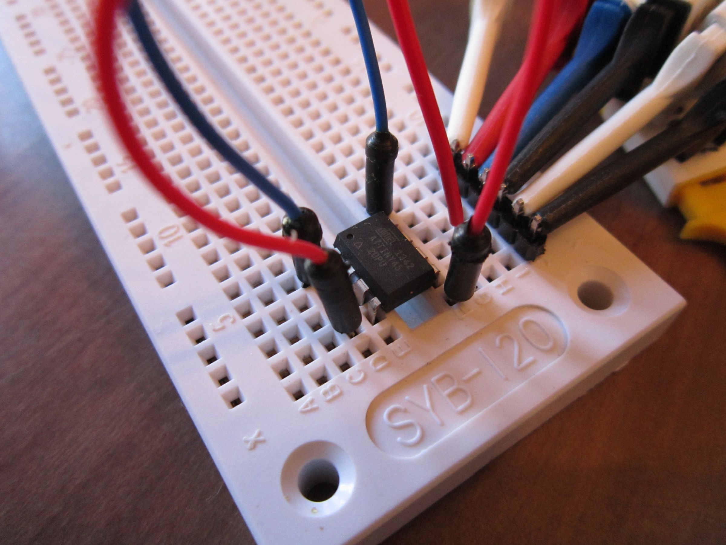

Step 1: First the Brain....
First, place the microcontroller on the printed circuit board. The microcontroller will go on the rectangle outline in the middle of the board. As you can see in the first picture, one end on the rectangle has a notch. Also, notice in the second picture that the microcontroller has a dot on one end. Make sure the dot on the microcontroller and notch on printer circuit board are on the same side, just like the pictures shown.
Now you can solder the microcontroller in.
