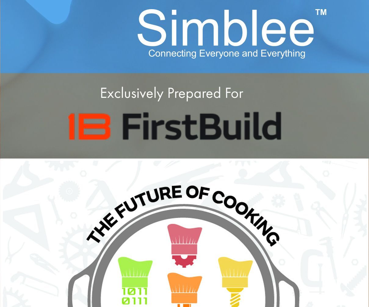

Flash your Simblee with your updated code, and check out your app!
Most of the UI objects that you'll see will change the text at the top of the screen.
Also, the numerical value that you see at the top is actually the temperature of the Simblee!
That text field is being updated every half second!
Pretty rad, right?
