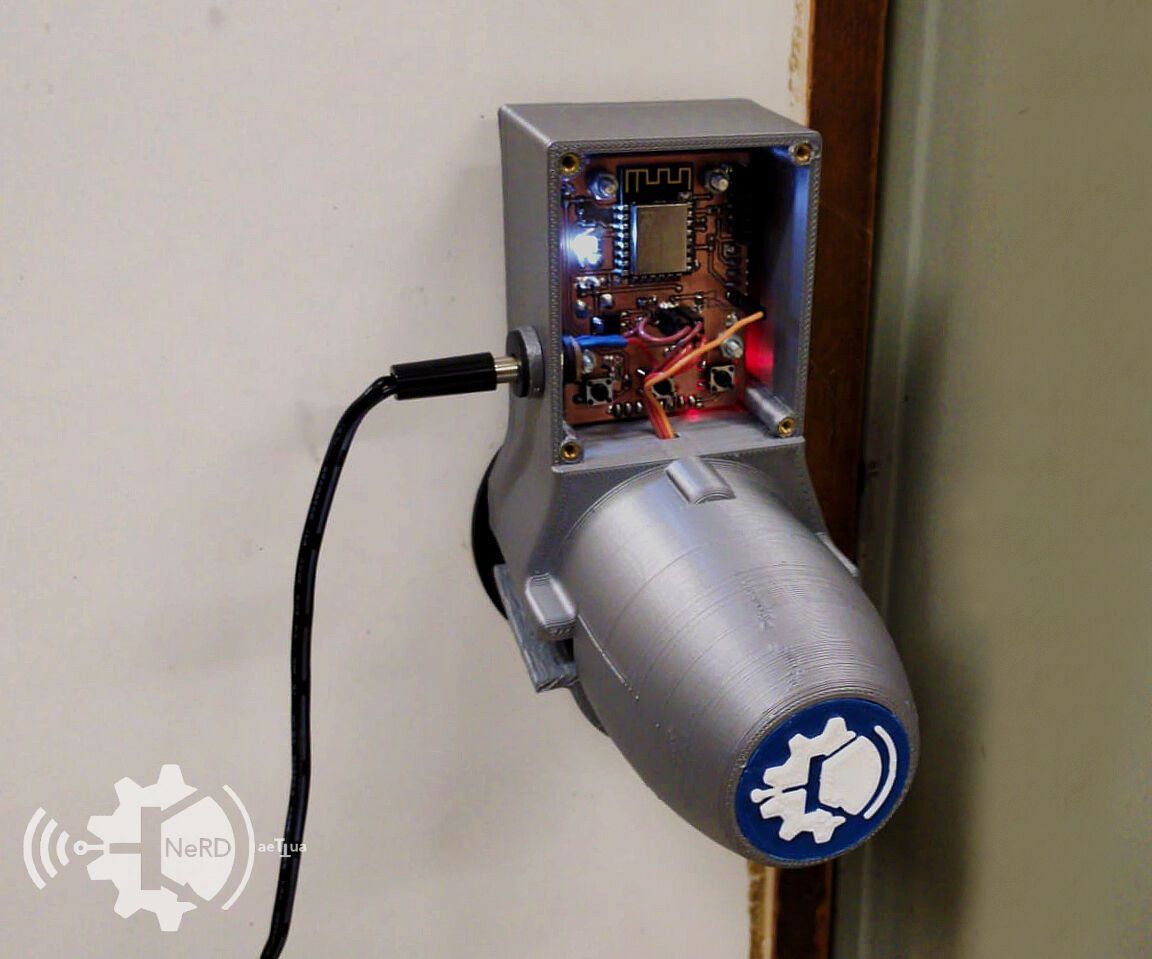

Step 1: Step 1: Printing the Skeleton
First of
all you need to start by printing the main structure by the name of Skeleton; on our model the color chosen was black. It’s highly recommended that you set up the printer to 20% of infill with a resolution of 0.2 with support enabled.
Ahhh the skeleton... a beautiful piece of NeRD design and engineering… It´s ready for that awesome hardware but first you need to dry fit all the components.
Step 2: Step 2: POWER!
Now at last with all the components fitted on their places we shall begin! To mount the power supply you need secure it tightly to the base, hot glue works miracles doesn’t it? Now you must leave available 5V to power the Raspberry (we chose to connect to the GPIO, although you have the option to use the USB) and the 12V for powering the fan later on. Don’t forget of course to install correctly the AC connector and to glue it on the side of the Skeleton.
Step 3: Step 3: the Brain or Rasp
See? It’s easy! While doing the following steps it’s recommended that you begin printing The RasPro Foot and RasPro Top both with 25% infill and a resolution of 0.2. The later should have 3 top layers. Now the brain! If you completed Step 1 it should fit right on and you can glue it to the main structure.
Step 4: Step 4: the Fan
Unlike the previous Steps glue isn’t needed! The fan is positioned on the large square socket which you can secure with the screws and nuts for easy maintenance. Now you can connect the 12V cable left available at Step 2 to the fan and voilá!
Step 5: Step 5: Electrify the Beast!
Onward to the dangerous part of the project. To power the Raspberry we opted to connect the 5V to the GPIO pins, although you also have the option to connect it to the USB. This choice we leave to your experience and preference. To power the fan you must connect the 12V and it’s more or less complete!
Step 6: Step 6: HDMI and Speaker
The semi-final step consists in attaching the HDMI adapter directly on the port of the Raspberry and fit it to be accessible from the side! To connect the speaker you must attach first of all the Audio Jack to the speaker. At last just pop the jack on the respective audio output on the Raspberry and it’s DONE!
Step 7: Step 7: Tcha-dan!!
On this last step you must cut a hole on the chosen side of the grater, in a way that all the connectors are accessible. Put the whole structure inside the grater, glue the RasPro Top to close the machine and glue the RasPro Feet. Tcha-dan! You are now a proud owner of a RasPro!
