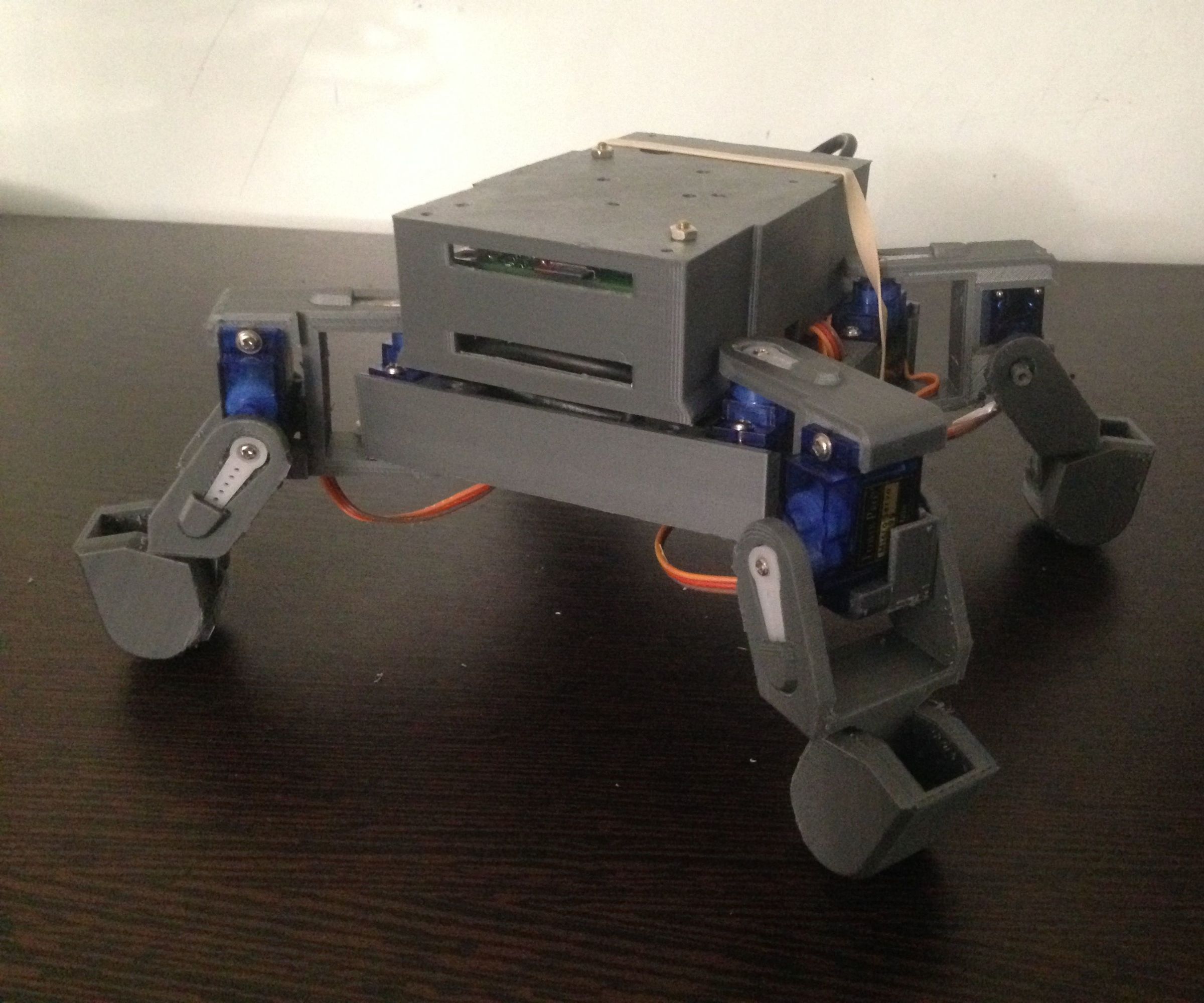

A simple Quadruped controlled by your phone(IOS and Android). Runs on Raspberry Pi and Android.

Step 1: 3D Printing
Print all the following parts:
- 1 x body_base.stl
- 1 x body_top.stl
- 2 x leg.stl
- 2 x hips.stl
- 1 x body_shafts.stl
You can also find all the files on the Thingiverse Page

Step 4: Installation of Servos on the Base
Step 5: Assembly of the Legs
Step 6: Joining Legs and the Base
Step 7: Wiring
Connect the Raspberry Pi to Arduino using a USB cable
Connect the Servos using the following port numbers:
FL_HIP = (4);
FL_FOOT = (5);
FR_HIP = (6);
FR_FOOT = (7);
BL_HIP = (8);
BL_FOOT = (9);
BR_HIP = (10);
BR_FOOT = (11);
