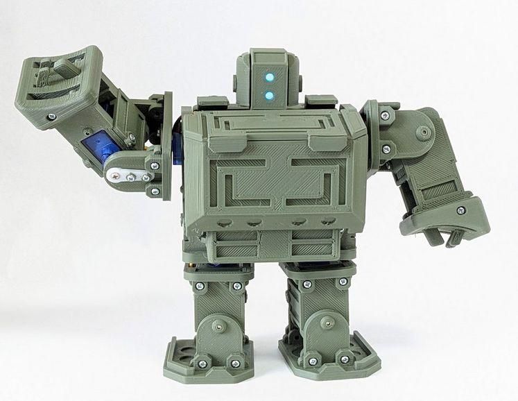

Introduction: Raspberry Pi Pico Open Remote Control Walking Robot "EasyPico"
About: I am a IT network engineer in Japan. I make robots as a hobby.
I tried to make a robot that everyone can enjoy.
3D Data, How to Make, and Code are open to the public.
You can put it together with parts that cost around 7000 Japanese yen (70 US dollars at ¥100/$, excluding PLA filament).
The power supply is designed to be safe with AAA batteries.
For example, how about as a material for STEM/STEAM education?
Or simply enjoy 😊
Concept is Easy
- Easy to gather parts.
- Easy to 3D print.
- Easy to assemble.
- Easy to program.
You can check the whole 3D preview by 3mf file.
Simple Parts
Basic Parts
- (x1) Raspberry Pi Pico W (Wifi, with pin header)
- (x1) Kitronik Simply Servos Board for Raspberry Pi Pico 5339
- (x8) Servo (TowerPro SG90 or Miuzei MS18 or Feetech FS90)
- (x4) AAA Rechargeable Batteries 1.2V or alkaline 1.5V
- (x1) AAAx4 Battery Case
- (x4) M2x8mm Machine Screws with Countersunk Head
- (x80) M2x4mm Tapping screws
For head LED (not required if you don't need LED)
- (x2) 3mm LED (built-in resistor type or regular with resistor)
- (x3) Jumper Wires (female to female) about 10cm
- (x3) Right angle pin header
About Kitronik Servo Board 5339
There are in two version.
Old (or Current depend on shop) Version
 You need USB Connection for moving Robot. Though it is not remote control, it works.
New Version (released 2024/3)
 Perfect remote control possible. You don't need USB Connection.
Refer to 'Example_Parts_Tool_List.pdf' for the Parts link and more information.
