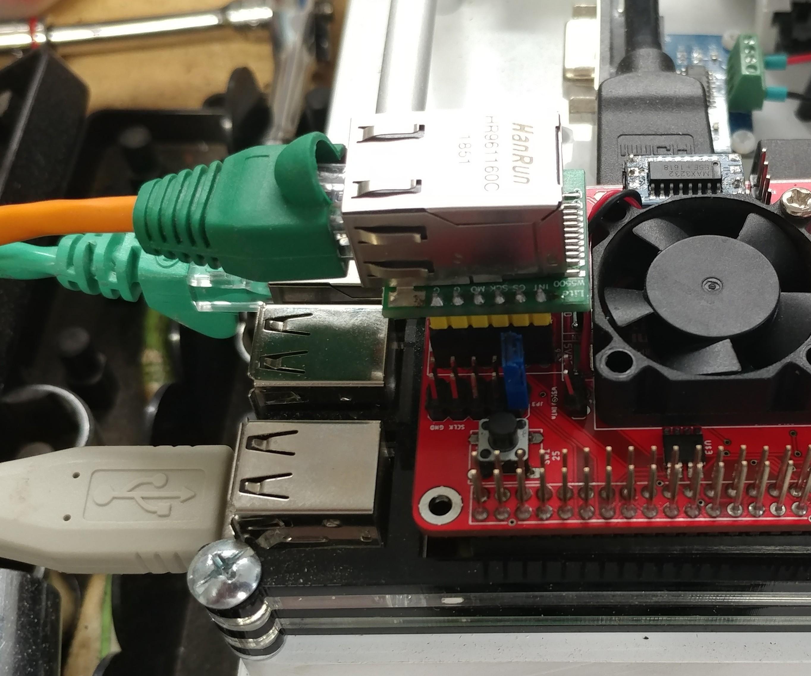

Step 1: The Raspberry Pi
As for the Raspberry Pi, I used three standard GPIO pins so this should work (I have not tested) with any Pi, or Orange board, Tinker board or clones that are available out there. You may (and should) comb through my overly commented Python code and select different GPIO pins if you are using a different processor, or just want to change things around a bit.
Please note that I am direct connecting to the GPIO pins on the RPi, so I'm limiting the voltage that the GPIO pins see to 3.3volts.
