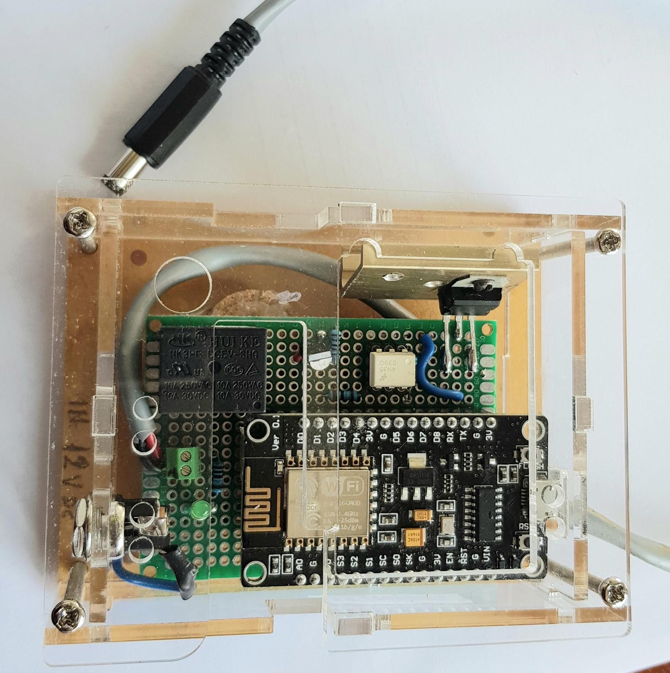

The most delicate thing from the hardware point of view was to make the frame for the display on the plastic box. I used the Dremel, with a small circular saw. The work is not perfect, but I can be satisfied. Of course, those who have the possibility of using a 3D printer could make a custom container.
The photos I attach can help to understand how the project was made.
Update
I made a hardware modification to be able to turn off the display LEDs after midnight and turn them back on in the morning and also to be able to temporarily turn them on when they are off.
To make this modification, simply interrupt the connection between the "LED" pin of the display and the +3.3V of the board and insert the small circuit that can be seen in the attached photo. All you need is a diode, a resistor, a low-power NPN transistor and a N.O. button. You also need to make a few additions to the code, to manage the interruption of the display LEDs.
Finally, I added the instructions to the code needed to be able to perform future updates via OTA. Of course, to take advantage of this mode, before uploading this code to the NodeMCU board, you must first upload the sketch, "Basic OTA", downloaded from the Arduino examples (after adding the SSID and PW of your WiFi to the sketch).
After uploading this code, open the serial and press reset on the board: you should read the IP address assigned by the router, which will be used to upload my sketch, after looking for the Port, from Arduino IDE Tools, and choosing the one with the assigned IP address.
