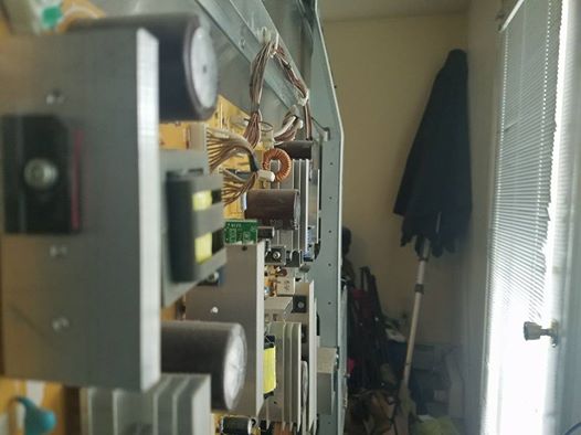

Step 3: What a Blown Capacitor Looks Like
A busted capacitor can be obviously broken (leaking brownish fluid, corroded, or with the leads severed), but sometimes it's subtle. The top of a blown capacitor will be slightly bent outwards in a convex shape, rather than flat or slightly indented inwards like a working capacitor. See the photos above for examples.
Think of it like a vacuum-sealed glass bottle. When the seal is intact, the bottle cap is flat, and when you break the seal, the bottle cap pops up. That subtle "popping-up" is exactly what you're looking for.

Make a note of the polarity of the old capacitor, and mark the exact values you'll need for the replacement: capacitance and voltage/temperature ratings (these may be written on the part itself, or you can look up the part number).
Press the tip of a heated soldering iron directly onto the solder joint on the back of the circuit board that is holding the old capacitor down. Hold on to the capacitor itself with your other hand. As the joint melts, you can feel the tip of the iron fall into the hole of the circuit board. As soon as it does, pull that side's wire lead out of the board. Then repeat with the other side.
This can take a bit of trial and error. The goal is to dig the very tip of the iron into the joint so that the solder in the hole heats and melts. If there's too much solder for your iron to reach the hole itself, you may want to use a soldering wick to get rid of some of the excess.

Step 5: Insert the New Capacitor
Trim the leads of the new capacitor so that they are both even, and will sit at about the same height as the old capacitor.
Position the new capacitor leads at the holes where the old capacitor was, with the correct polarity. Just like before, press the tip of the soldering iron directly onto the joint in the back of the circuit board. As soon as the tip falls into the hole, press the wire lead through the hole, then remove the iron. The old solder joint will solidify around the new part and hold it secure. Repeat with the other side. Add new solder to the joint if necessary.
