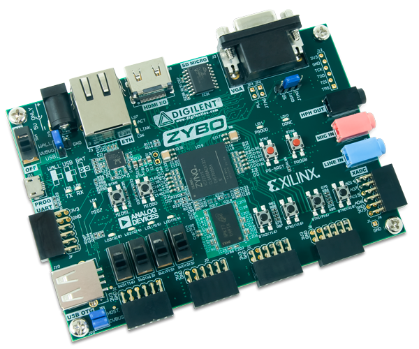

48-pin DIP form factor board built around a Xilinx Artix-7 FPGA
from Digilent.com
It can integrate programmable logic design directly into a solderless breadboard circuit.
At just 0.7” by 2.75”
The board also includes a USB-JTAG programming circuit, USB-UART bridge, clock source, Pmod host connector, SRAM, Quad-SPI Flash, and basic I/O devices.
The Cmod A7 is fully compatible with the high-performance Xilinx Vivado® Design Suite.
XC7A35T-CPG236
System Features
o 512KB SRAM with an 8-bit bus and 8ns access times o 4MB Quad-SPI Flash o USB-JTAG Programming Circuitry o Powered from USB or external 3.3-5.5V supply connected to DIP pins. System Connectivity o USB-UART bridge. Interaction and Sensory Devices o 2 LEDs o 1 RGB LED o 2 Push Buttons. Expansion Connectors o 48-pin DIP connector with 44 Digital I/O and 2 Analog inputs (0-3.3V) o One Pmod connector with 8 Digital I/O
