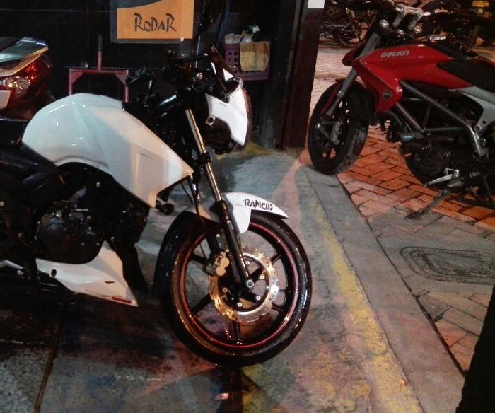

  • The device with the problematic fan inside (for this Instructable I'll repair my motorcycle LED headlight)
