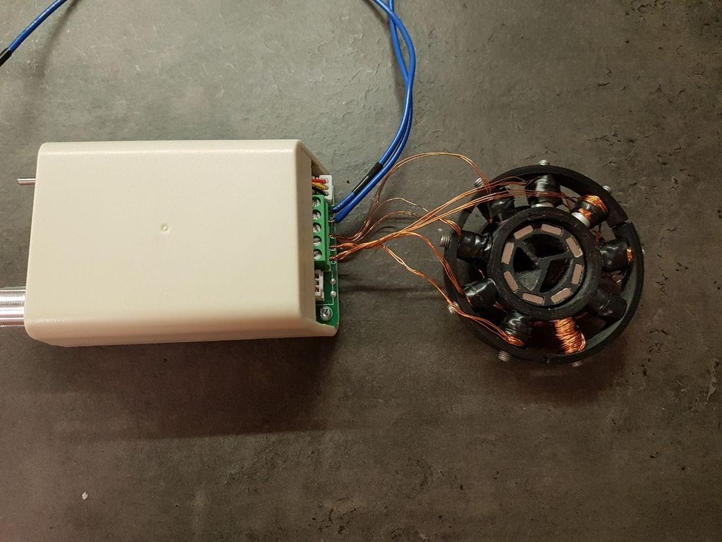

As we are planning on terminating Wye, mark the ending terminal of the wire. We'll need to join the ending terminals of all three phases when it comes time to terminate the motor as shown in following.
Step 8: Start Winding
1. Now you can start winding.
2. I used New-b wire (36 AVG) from a nearby winding shop.
3. It has extra insulation to prevent shorts. I chose three strands of 36 gauge wire. So it will be an 8 turn of 8 wire bundle wind.
4. Start winding with any pole you like. Go only in one direction (I went clockwise). Once you complete the number of turns you decided on earlier, skip two poles and continue winding the next. Repeat this process until one third of the poles are wired. It should look like the picture below when you are done.
5. Here third winding is to be done.
6. Now before you begin with your next set of armatures, check for stator shorts with an ohm meter (multi tester). The resistance between the wire and the metal of the stator should be infinite (i.e. not continuity).
7. If you don't get a short, good job. Move on to the next set of armatures. If you have a short, unwind that entire phase get a new wire and start over.
8. Side note: When winding, do not tug on the wires too hard. 1-2 lbs is plenty. Winding too tight will result in a shorted winding to the stator. If you find that your wires are not snug against your stator you can use a non-metallic object such as a broken prop, flat carbon rod, or my favourite, a credit card to slide between the stator poles.
9. Do tag the start and end of winding.
10. Here start tag is S1 and end of 1st winding is E1 as seen in picture.
